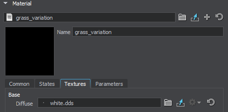

  5. Adjust the materials of the grass objects: for each material, go to the Textures tab and drag the diffuse texture to the corresponding field.

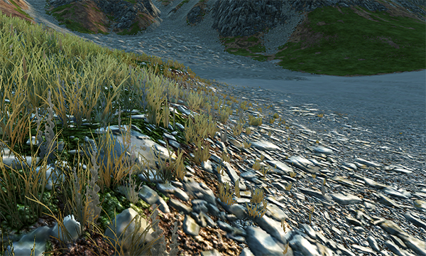

    You can see patches of light green and yellow grass:
  13. The colors are too vivid to match the terrain colors. Drop the Scale to 0.38 to dim the noise color.

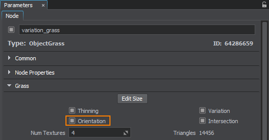

  3. Unlike trees, the grass is usually grows perpendicular to the terrain. Check the Orientation in the Grass tab of the Parameters window to orient the grass objects along the normal of the terrain. Perform it for both regular and variation grass.
