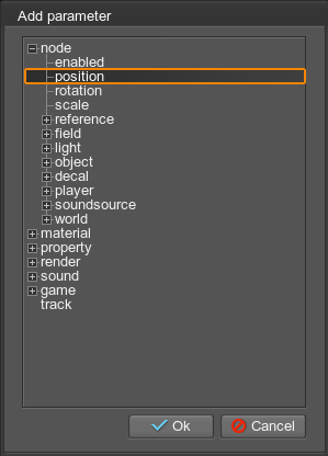

  1. Add a track that will animate the movement of our camera: Click . This will open the Add Parameter window.添加一个控制摄像机移动的轨道:点击。这将打开Add Parameter(添加参数)窗口。
  2. Select a parameter from the list, in our case it will be node → position.从列表中选择参数,本例中选择node → position

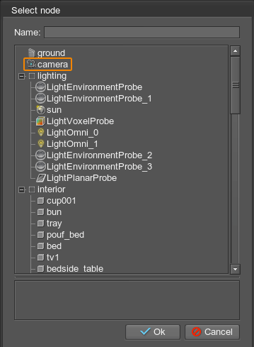

  3. Since the track animates the movement of the camera (Player) node, you must bind it to a specific node in the Select Node window that opens. Select the camera node and click Ok.由于该轨道将动画化cameraPlayer)节点的移动,你需要在弹出的Select Node(选择节点)窗口中将其绑定到特定节点。选择camera节点并点击OK

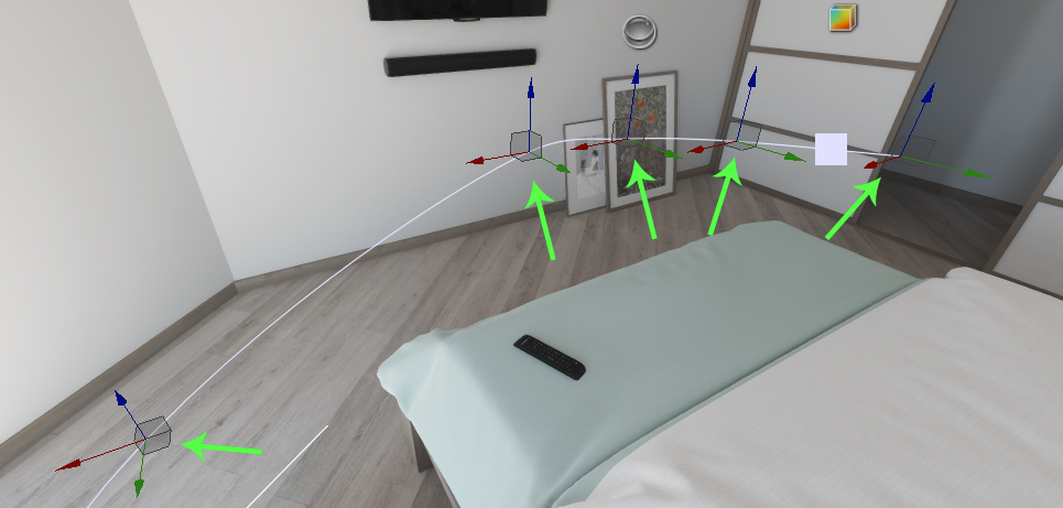

During playback, you can switch to the Editor Camera view in the viewport and see how the camera node moves along the trajectory. Here you can also move the manipulators placed at key points to change the trajectory in real time.在播放过程中,你可以切换到视口中的编辑器摄像机(Editor Camera)视图,观察摄像机节点(camera)如何沿轨迹移动。在此你还可以实时移动关键点处的操纵器来调整轨迹。
