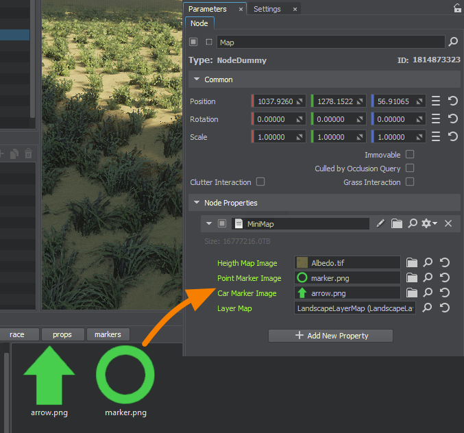

Let's create one more NodeDummy for the MiniMap component and set the images for the background and markers and the LandscapeLayerMap node — the terrain layer.让我们再创建一个 NodeDummy,用于挂载 MiniMap 组件,并设置背景图像、标记图像以及 LandscapeLayerMap 节点 —— 即地形图层。

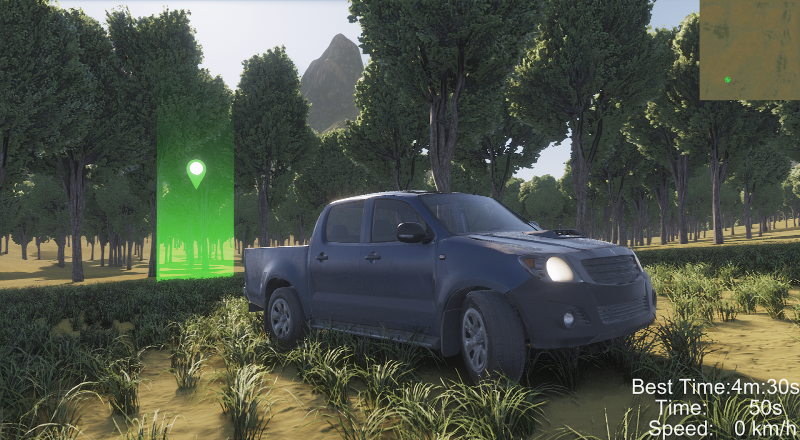

Find the race/props/checkpoint/CheckPoint.node asset and add it to the scene by dragging with the left mouse button in the viewport.找到 race/props/checkpoint/CheckPoint.node 资源,并通过在视口中左键拖动将其添加到场景中。
This is a Node Reference, click Edit to modify this instance. It has a cylinder and a decal inside to visualize the checkpoint. Our task is to create a new node via the menu Create → Logic → Physical Trigger, make it a child of the point node, and place within the checkpoint bounds by selecting the Cylinder type and setting the required size.这是一个 节点引用(Node Reference),点击 Edit 按钮可修改该实例。它内部包含一个圆柱体和一个贴花(decal)用于可视化检查点。我们的任务是通过菜单 Create → Logic → Physical Trigger 创建一个新节点,将其作为 point 节点的子节点,并选择 Cylinder 类型后调整大小以使其位于检查点区域内。
Then select the top point node and assign the CheckPoint component to it. Make sure to set the trigger in the component parameters by dragging the child PhysicalTrigger to the corresponding field.然后选中顶部的 point 节点,并将 CheckPoint 组件赋予它。确保将该组件参数中的触发器设置好——将子节点 PhysicalTrigger 拖动到对应字段中。
After that, save the Node Reference by clicking Apply, then create several instances of the CheckPoint node, and place them on the landscape, mapping out a small track consisting of points.之后,点击 Apply(应用) 保存 节点引用(Node Reference),然后创建多个 CheckPoint 节点实例,并将它们放置在地形上,组成一个由若干点构成的小型赛道。

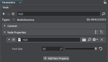

A simple interface displaying the current speed, timer, and the best race time would be a nice thing to have. Let's create a separate HUD component for that and add the methods to update the values from outside. Assign the HUD component to a separate NodeDummy node.一个简单的界面用于显示当前速度、计时器和最佳比赛时间会很有帮助。我们将为此创建一个独立的 HUD 组件,并添加一些方法以便从外部更新这些值。将 HUD 组件挂载到一个独立的 NodeDummy 节点上。
HUD.h
#pragma once
#include <UnigineGui.h>
#include "GameTimer.h"
class HUD :
	public Unigine::ComponentBase
	// 组件构造函数和方法列表
	COMPONENT_DEFINE(HUD, ComponentBase)
	COMPONENT_INIT(init);
	COMPONENT_SHUTDOWN(shutdown);
	// 组件参数
	// HUD 的字体大小
	PROP_PARAM(Int, font_size, 50);
	// 显示/隐藏 HUD
	void show();
	void hide();
	// 设置要显示的参数值
	void setSpeed(float speed);
	void setTime(double time);
	void setBestTime(double time);
	// UI 小部件
	Unigine::WidgetLabelPtr speed_label = nullptr;
	Unigine::WidgetLabelPtr time_label = nullptr;
	Unigine::WidgetLabelPtr best_time_label = nullptr;
	Unigine::WidgetVBoxPtr vbox = nullptr;
protected:
	// 主循环重写函数
	void init();
	void shutdown();
HUD.cpp
#include "HUD.h"
REGISTER_COMPONENT(HUD);
void HUD::init()
	GuiPtr gui = Gui::getCurrent();
	vbox = WidgetVBox::create(gui);
	WidgetLabelPtr label = nullptr;
	WidgetGridBoxPtr grid = WidgetGridBox::create(gui, 2);
	label = WidgetLabel::create(gui, "Best Time:");
	label->setFontSize(font_size);
	best_time_label = WidgetLabel::create(gui, "");
	best_time_label->setFontSize(font_size);
	grid->addChild(label);
	grid->addChild(best_time_label);
	label = WidgetLabel::create(gui, "Time:");
	grid->addChild(time_label);
	label = WidgetLabel::create(gui, "Speed:");
	speed_label = WidgetLabel::create(gui, "");
	speed_label->setFontSize(font_size);
	grid->addChild(speed_label);
	vbox->addChild(grid);
	gui->addChild(vbox, Gui::ALIGN_BOTTOM | Gui::ALIGN_RIGHT | Gui::ALIGN_OVERLAP);
void HUD::shutdown()
	gui->removeChild(vbox);
	vbox.deleteLater();
	vbox = nullptr;
void HUD::setSpeed(float speed)
	speed_label->setText(String::format("%d km/h", Math::toInt(speed)));
void HUD::setTime(double time)
	time_label->setText(GameTimer::secondsToString(time));
void HUD::setBestTime(double time)
	best_time_label->setText(GameTimer::secondsToString(time));
void HUD::show()
	vbox->setHidden(false);
void HUD::hide()
	vbox->setHidden(true);
Save all the files that we modified and then build and run the application by hitting Ctrl + F5 to make the Component System generate a property to be used to assign the components to nodes. Close the application after running it and switch to UnigineEditor.保存所有我们修改过的文件,然后按下 Ctrl + F5 来构建并运行应用程序,从而使组件系统生成用于将组件分配到节点的属性。运行结束后关闭应用程序,并切换回 UnigineEditor。

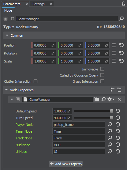

We finally got to the main GameManager component, which ties together all the game logic and sets the game rules. It controls the timer, the track, the interface, and the end game screen.我们终于来到了主要的GameManager组件,它将整个游戏逻辑整合在一起并设定游戏规则。它负责控制计时器、赛道、界面和游戏结束界面。
Let's add one more standard speed parameter to calculate the standard time for the generated tracks, this time will be considered the best until the result is updated by the player.让我们再添加一个标准速度参数,用于计算生成赛道的标准完成时间,在玩家打破记录之前,该时间将被视为最佳成绩。

Now assign the component to a dedicated node and set the links to the corresponding components by dragging the nodes to which they are assigned into the corresponding fields in the Parameters window.现在,将该组件分配给一个专用节点,并在 参数Parameters)窗口中,将各个字段对应的节点拖拽到组件的相应字段中,以设置对其它组件的引用。
Set moderate standard speed for the timer, taking into account that one needs to get used to driving on mountainous terrain.为计时器设置一个适中的标准速度,考虑到在山区地形上驾驶需要一定的适应时间。
To simplify customization of rendering settings for beginners, the template_simplified.node preset with optimal settings has been added to the race folder. To apply it, double-click on the asset, or go to the Settings window, select any subsection of the Render section and select the desired preset in the Render Preset parameter.为了简化初学者对渲染设置的定制,race 文件夹中添加了一个具有优化设置的预设文件 template_simplified.node。要应用该预设,可以双击该资源,或在 设置Settings)窗口中,选择 Render 部分的任意子部分,在 Render Preset 参数中选择所需预设。
Done, now you can build the project and enjoy the game!完成,现在你可以构建项目并享受游戏了!
