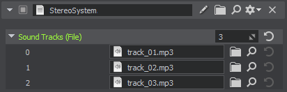

Assign the StereoSystem component to the tv1 node in the scene (interior -> tv1) and add tracks from the archviz/sounds folder to the Sound Tracks list:StereoSystem组件分配给场景中的tv1节点(interior -> tv1),并从archviz/sounds文件夹添加音轨到Sound Tracks列表:
