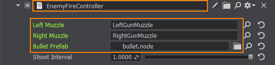

    Save all the files that we modified and then build and run the application by hitting Ctrl + F5 to make the Component System update properties used to assign the components to nodes. Close the application after running it and switch to UnigineEditor.保存文件,然后按Ctrl + F5构建并运行应用程序,使组件系统生成用于将组件分配给节点的属性文件。运行应用程序后将其关闭,然后切换到UnigineEditor。
  2. If necessary, enable editing of the robot_enemy node and assign the EnemyFireController component to the robot_root Dummy Object.如需编辑robot_enemy节点,将EnemyFireController组件分配给robot_root (Dummy Object)
  3. Drag and drop the LeftGunMuzzle and RightGunMuzzle Dummy Nodes to the corresponding fields of the EnemyFireController component.LeftGunMuzzleRightGunMuzzle虚拟节点拖放到EnemyFireController组件的对应字段。
  4. Drag and drop data/fps/bullet/bullet.node to the Bullet Prefab field.data/fps/bullet/bullet.node拖放到Bullet Prefab字段。
The right gun muzzle is selected已选择右枪管作为初始射击点
