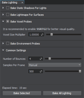

  1. Enable the Lightmap buffer (Rendering → Buffers → Lightmap).启用光照贴图缓冲区(Rendering → Buffers → Lightmap)。
  2. Open the Bake Lighting window.打开Bake Lighting(烘焙光照)窗口。
  3. Enable Bake Voxel Probes and adjust Voxel Size Multiplier, if necessary:启用 Bake Voxel Probes(烘焙体素探针)选项,必要时调整 Voxel Size Multiplier(体素尺寸倍增器):
    • Configure Baking Viewport Masks to select the light sources and surfaces that should be baked.配置 Baking Viewport Masks(烘焙视口遮罩)以选择需要烘焙的光源和表面
    • Set the baking Quality: Draft is suitable for quick iterations, and Ultra provides the maximum quality.设置烘焙质量 (Quality):Draft(草稿)模式适合快速迭代,Ultra(极致)模式提供最高质量。
    • Adjust Far Clipping Distance for clipping the light rays.调整 Far Clipping Distance(远裁剪距离)以控制光线裁剪范围
  4. Set the number of light ray bounces (higher values will result in a brighter lighting).设置光线反弹次数(数值越高光照越亮)。
  5. Start baking process for all objects by clicking Bake All Lighting and wait for it to finish. Live preview of the process is available (the number of samples counted per frame can be adjusted during the baking process).点击Bake All Lighting(烘焙全部光照)开始全场景烘焙,等待完成(可实时预览烘焙进度,烘焙过程中可调整每帧采样数)。
  6. The generated lightmaps are saved to the bake_lighting/voxel_probes folder and applied to the corresponding Voxel Probes.生成的光照贴图将保存至bake_lighting/voxel_probes文件夹,并应用到对应的体素探针。
  7. To improve the quality, you can also enable Lightmap Cubic Filtering in the material settings of the surfaces with the light map.如需提升质量,可在材质设置中为光照贴图表面启用Lightmap Cubic Filtering(立方体贴图过滤)。
  8. The result can be checked by selecting the Indirect Lighting mode in the Rendering Debug menu.通过Rendering Debug(渲染调试)菜单选择Indirect Lighting(间接光照)模式查看效果。
