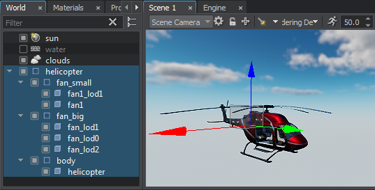

  1. Create the base hierarchy. Prepare the base hierarchy that will represent your object. For example, if you want to use a helicopter repeatedly in your world, assemble a hierarchy of nodes with materials, animations, logic components, and everything else that you need. 创建基础层次结构。准备将代表你对象的基础层次结构。例如,如果你想在你的世界中重复使用直升机,请组装一个包含材质、动画、逻辑组件和你需要的所有其他内容的节点层次结构。

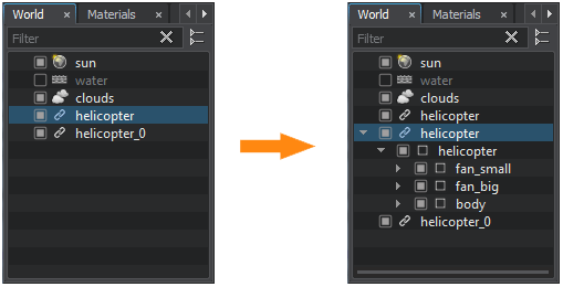

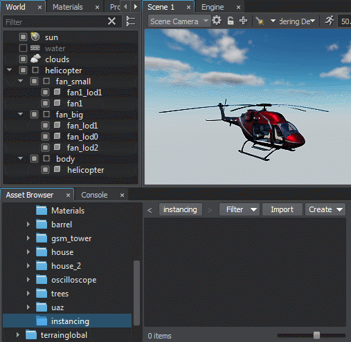

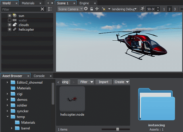

  2. Convert the node hierarchy into a Node Reference. Simply drag and drop the root node of the hierarchy to the desired folder in Asset Browser. A corresponding *.node (template) asset containing the hierarchy will be created in the folder. The node hierarchy in the world will be replaced by a reference to this asset.将节点层次结构转换为节点引用。只需将层次结构的根节点拖放到资源浏览器中的目标文件夹即可。将在该文件夹中创建一个包含层次结构的相应*.node(模板)资源。世界中的节点层次结构将被替换为此资源的引用。
  3. Place instances. The first instance in the world is the one that replaced the hierarchy when you dragged it into Asset Browser. You can add other instances by dragging the desired *.node template from Asset Browser directly to the scene or by cloning the Node Reference like any other node (Shift+Drag).放置实例。世界中的第一个实例是当你将层次结构拖到资源浏览器时替换层次结构的实例。你可以通过从资源浏览器直接将所需的*.node模板拖到场景中,或像任何其他节点一样克隆节点引用(Shift+拖拽)来添加其他实例。

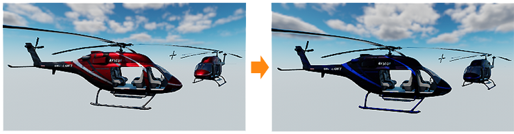

When you edit any instance and save the changes, the template and all other instances are automatically updated. This approach ensures integrity when changing the parameters of reusable objects, especially if they are complex. This process looks as follows:当你编辑任何实例并保存更改时,模板和所有其他实例都会自动更新。这种方法在更改可重用对象的参数时确保了完整性,特别是当它们很复杂时。这个过程如下所示:
  1. Select any instance in the world through the Editor Viewport or World Nodes Hierarchy window. The Node Reference parameters will be displayed in the Parameters window.通过 Editor Viewport 或世界节点层次结构窗口选择世界中的任何实例。节点引用参数将显示在参数窗口中。
  2. Click Edit. The hierarchy of the original Node Reference will be displayed in the World Nodes Hierarchy window.点击 Edit。原始节点引用的层次结构将显示在世界节点层次结构窗口中。
  3. Edit the source Node Reference. You can make any changes: change materials, add new nodes, delete existing nodes, etc.编辑源节点引用。你可以进行任何更改:更改材质、添加新节点、删除现有节点等。
  4. Click Apply to save your changes or Cancel to discard them. The changes will be applied to all instances at once.点击 Apply 保存你的更改或点击 Cancel 放弃它们。更改将立即应用于所有实例。
