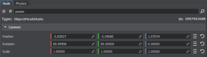

  3. Set poster's transformation as shown on the image below:按照下图设置海报的变换参数:

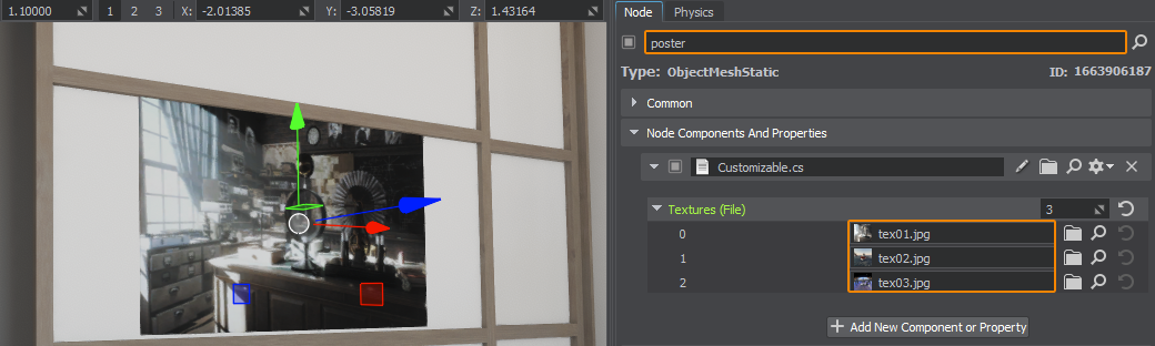

Let's save our files and then build and run our application by hitting Ctrl + F5 to make the Component System generate a property to be used to assign our component to nodes. Close the application after running it and switch to UnigineEditor.让我们保存我们的文件,然后通过按Ctrl + F5来构建并运行我们的应用程序,以使组件系统生成一个属性,用于将我们的组件分配给节点。运行后关闭应用程序并切换到UnigineEditor。
Then let's assign our component to the poster node and fill the texture array (tex01, tex02, tex03).然后将该组件分配给poster节点,并填充纹理数组(tex01、tex02、tex03)。
Now the image on the poster can be changed in one click.现在只需点击一次即可更改海报上的图像。
