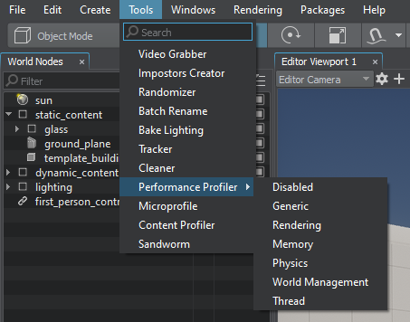

To turn on the profiler, click Tools -> Performance Profiler in the main menu of UnigineEditor and choose the required profiling mode.要启用性能分析器,请在UnigineEditor主菜单中点击Tools -> Performance Profiler(工具→性能分析器),然后选择所需的剖析模式。
Depending on the selected mode, the set of displayed data will differ:根据所选模式的不同,显示的数据集也有所差异:
  • Generic profiler shows the general statistics block only. It includes such indicators as total time taken to calculate and render the current frame, time spent on updating the application logic, GPU waiting time, CPU rendering time, GUI rendering time, physics calculations, allocated memory size, as well as the number of synchronous and asynchronous threads. This general statistics block is available in all profiling modes.Generic profiler(通用分析器)仅显示基础统计模块。包含以下指标:当前帧计算与渲染总耗时、应用逻辑更新耗时、GPU等待时间、CPU渲染时间、GUI渲染时间、物理计算耗时、内存分配量,以及同步/异步线程数量。该基础统计模块在所有剖析模式中均可查看。
  • Rendering profiler shows the detailed rendering statistics and the timeline chart.Rendering profiler(渲染分析器)显示详细的渲染统计数据及时间轴图表。
  • Physics profiler shows the detailed physics-related statistics (within the Physics radius) and the timeline chart.Physics profiler(物理分析器)展示物理相关详细统计(在Physics radius范围内)及对应时间轴图表。
  • World Management profiler shows the statistics on the currently loaded virtual world: total number of nodes, physical bodies, and joints, as well as time spent on procedural content creation (e.g. grass and clutters).World Management profiler(世界管理分析器)提供当前加载虚拟世界的统计数据:节点总数、物理体数量、关节数量,以及程序化内容生成耗时(如草地和植被群)。
  • Thread profiler shows the statistics on loading threaded resources: time of asynchronous loading of resources, sounds, as well as asynchronous pathfinding calculations.Thread profiler(线程分析器)显示线程资源加载统计:资源异步加载耗时、声音加载耗时,以及异步寻路计算耗时。

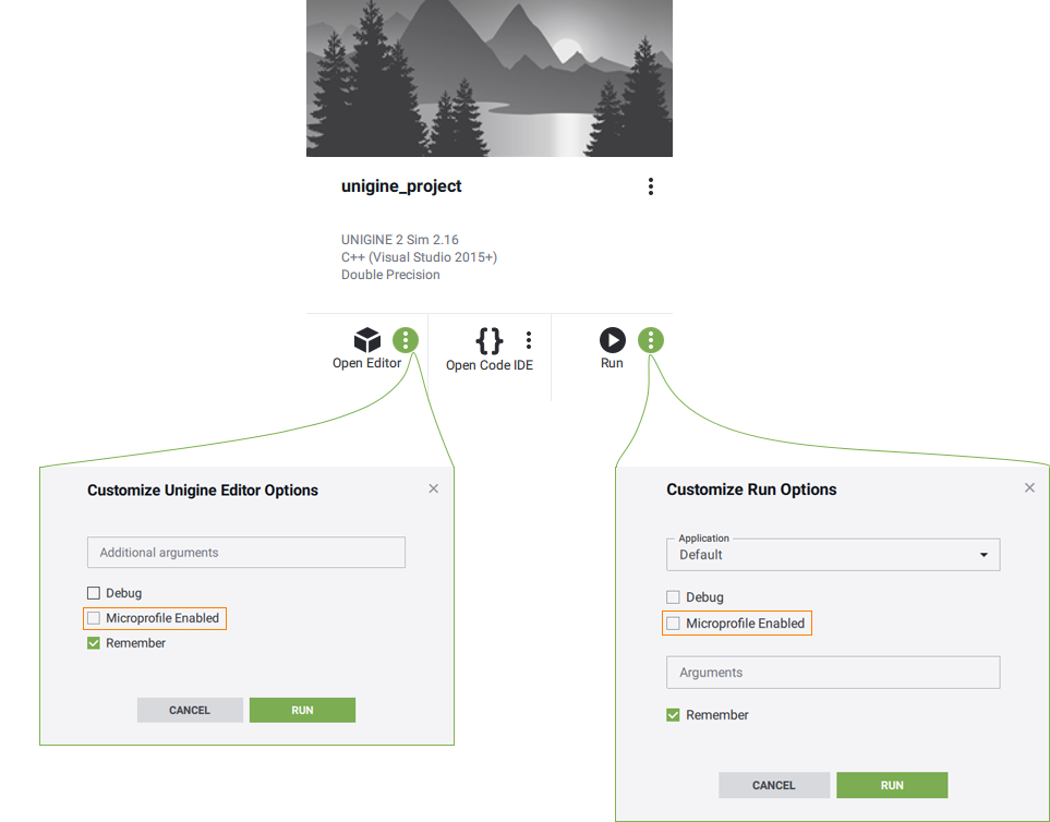

You can check if Microprofile is enabled and turn it on using the microprofile_info console command. If it is disabled, you will need to change project settings in UNIGINE SDK Browser and restart the application:你可以通过microprofile_info控制台命令检查Microprofile是否启用并进行开关。若未启用,需在UNIGINE SDK Browser中修改项目设置并重启应用程序:
Microprofile should only be enabled when you are working with it. If you do not use performance profiling at a certain stage of working with your project, disable this tool.仅在需要使用Microprofile时开启。在项目开发的某些阶段若无需性能分析,请关闭此工具。

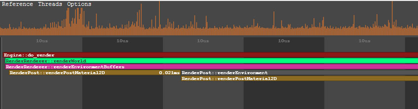

Microprofile visualizes the detailed per frame performance data on operations performed by the engine on CPU and GPU and in the engine threads.Microprofile可视化引擎在CPU、GPU及引擎线程上执行操作的每帧详细性能数据。
The Microprofile tool requires a Warmup of 1000 frames at startup for the displayed information to be valid. This can take 16 to 30 seconds.Microprofile工具启动时需要1000帧的预热(Warmup),所显示的信息才能有效。这可能需要16到30秒时间。
There are several modes for displaying performance data. You can switch between them in the Microprofile main menu: click Mode and select the desired one. The Detailed mode is set as a default one, as it provides the exhaustive information.性能数据显示有几种模式。你可以在Microprofile主菜单中切换:点击Mode并选择所需模式。默认设置为Detailed模式,该模式提供最详尽的信息。
In this mode, the interface is divided into two parts:在此模式下,界面分为两部分:
  • Main workspace that contains detailed information about each rendered frame. Each operation (function) and thread is displayed as a separate colored region. The regions are hierarchical: the function is a parent to the function that it calls and is displayed above it. The size of the region is determined by the time the corresponding operation takes. The workspace can be moved and scaled.主工作区包含每帧渲染的详细信息。每个操作(函数)和线程都显示为独立的彩色区域。这些区域具有层级结构:调用其他函数的函数作为父级显示在上方。区域大小由对应操作的耗时决定。工作区可移动和缩放。
  • Frame sequence that is used to easily navigate through the collected data. Each column is a frame. The column height corresponds to the frame rendering time. If you click on a column, you will quickly switch to the data collected on that frame. The last frames in the sequence provide the most valuable data for performance evaluation.帧序列用于便捷浏览收集的数据。每列代表一帧,列高对应帧渲染时间。点击某列可快速切换到该帧收集的数据。序列末尾的帧对性能评估最具参考价值。
Performance data is displayed horizontally in several threads:性能数据在多个线程上水平显示:
  • GPU thread shows the call stack of the operations performed by the engine on GPU.GPU线程显示引擎在GPU上执行的操作调用栈。
  • Main engine thread show the call stack of the operations (such as update, rendering, etc.) performed on the CPU side.主引擎线程(Main)显示CPU端执行的操作(如update、rendering等)调用栈。
  • Other engine threads (CPUThread, SoundThread, AsyncQueueThread, WorldSpawnMeshClutterThread, WorldSpawnGrassThread).其他引擎线程(CPUThread, SoundThread, AsyncQueueThread, WorldSpawnMeshClutterThread, WorldSpawnGrassThread)。
Each frame starts from the update() function.每帧都从update()函数开始执行。

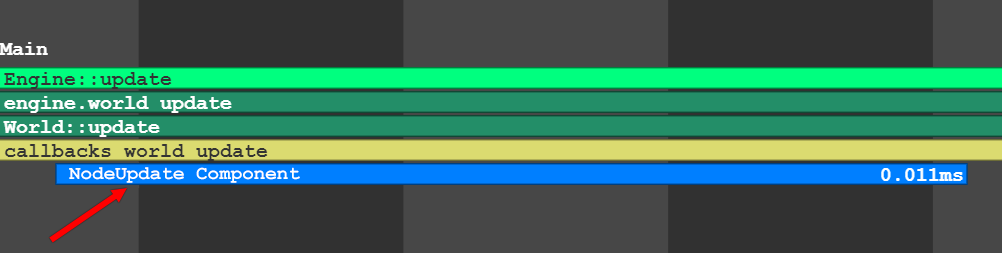

You can use the Microprofile to inspect performance of your application logic.你可以使用Microprofile来检查应用程序逻辑的性能。
Let's review a simple example. Suppose you have a C++ component that moves a node in the scene and enables/disables it depending on its position in the current frame.让我们看一个简单例子。假设你有一个C++组件,它根据当前帧中的位置移动场景节点并启用/禁用该节点。
To find out how long it takes to execute such logic, you can use the Profiler class methods:要了解执行此类逻辑所需的时间,你可以使用Profiler类方法:
  1. At the beginning of the update() method call Profiler::begin(). Specify the counter name that will be displayed in Micropofile as its argument. At the end of the method call Profiler::end().update()方法开头调用Profiler::begin()。将其参数指定为将在Micropofile中显示的计数器名称。在方法结尾调用Profiler::end()
    NodeUpdate.h
    #pragma once
    class NodeUpdate :
    	public Unigine::ComponentBase
    	// 为我们的类声明构造函数和析构函数,并定义与该组件关联的属性名称
    	// 首次运行应用程序后,包含以下所有参数的Fan.prop文件将在项目的data文件夹中生成
    	COMPONENT_DEFINE(NodeUpdate, ComponentBase);
    	// 注册要在世界逻辑相应阶段调用的方法(方法在下面的protected部分声明)
    	COMPONENT_UPDATE(update);
    protected:
    	// 声明要在世界逻辑相应阶段调用的方法
    	void update();
    NodeUpdate.cpp
    #include "NodeUpdate.h"
    #include<UnigineProfiler.h>
    #include<UnigineGame.h>
    REGISTER_COMPONENT(NodeUpdate);
    // 组件每帧调用的update方法
    void NodeUpdate::update()
    	// 开始性能分析
    	Profiler::begin("NodeUpdate Component");
    	float time = Game::getTime();
    	Vec3 pos = Vec3(Math::sin(time) * 2.0f, Math::cos(time) * 2.0f, 0.0f);
    	// 修改节点的启用标志
    	node->setEnabled(pos.x > 0.0f || pos.y > 0.0f);
    	// 修改节点的世界坐标位置
    	node->setWorldPosition(pos);
    	// 结束性能分析
    	Profiler::end();
  2. Build and run the Release version of the project by selecting the Release configuration (see the image below for MS Visual Studio) and hit Ctrl + F5.通过选择Release配置(如下图所示为MS Visual Studio界面)构建并运行项目的Release版本,然后按Ctrl + F5启动。
  3. Run the microprofile_enabled 1 console command, if Microprofiler hasn't been enabled via SDK Browser yet.执行microprofile_enabled 1控制台命令(若尚未通过SDK Browser启用Microprofiler)。
  4. Open Microprofile in the web browser.在网页浏览器中打开Microprofile
  5. Find the region with the name you passed to the Profiler::begin() function. In our example that is "NodeUpdate Component".查找与你传入Profiler::begin()函数的名称对应的区域(本示例中为"NodeUpdate Component")。
    The Profiler::begin() and Profiler::end() functions make the code snippet available to both Profiler and Microprofile. If you want to use only Microprofile, use the Profiler::beginMicro() and Profiler::endMicro() functions. Note that their calls are different: Profiler::beginMicro() returns an identifier to be passed to Profiler::endMicro().Profiler::begin()Profiler::end()函数使代码片段同时适用于Profiler和Microprofile。若需仅使用Microprofile,请改用Profiler::beginMicro()Profiler::endMicro()函数。注意其调用方式不同:Profiler::beginMicro()需将返回的标识符传入Profiler::endMicro()
