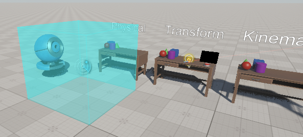

The main features of the VR Sample:
  • VR support (Oculus Rift and HTC Vive/OpenVR)
  • A set of physical objects that can be manipulated via controllers (physical objects, buttons, drawers)
  • An interactive laser pointer object
  • Teleportation around the scene
  • GUI
  • Interaction with GUI objects via controllers

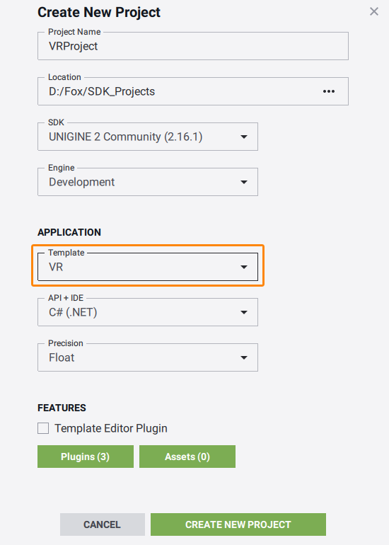

Let's create a project based on C# VR Template.
  1. Open SDK Browser, go to the My Projects tab and click Create New.
  2. In the Create New Project, specify the project name VRProject, in the Template menu choose VR, and in the Precision menu choose Float. Then click Create New Project.
  3. When the project is successfully created, open it in UnigineEditor.
  4. In the Asset Browser, open the vr_sample.world file located in the data/vr_template/vr_sample/ folder. We will work with this world.

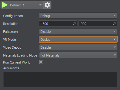

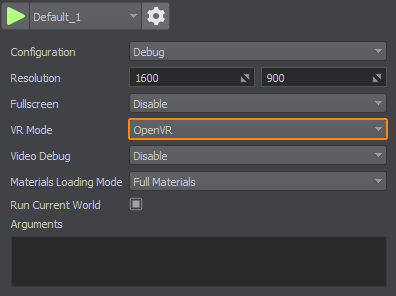

If you run the application via UNIGINE SDK Browser, set the Stereo 3D option to HTC Vive in the Global Options tab and click Apply:
To launch the application, specify the corresponding VR mode:
If you run the application via UNIGINE SDK Browser, set the Stereo 3D option to Oculus Rift in the Global Options tab and click Apply:
You can also specify the plugin to be loaded for your application via the Customize Run Options.
Run the application and learn about basic mechanics, grab and throw objects, try to teleport and interact with objects in the scene.

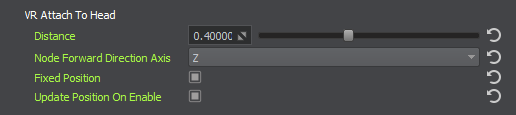

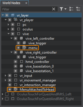

3.1. Attaching Object to HMD#
Sometimes it might be necessary to attach some object to the HMD to follow it. It can be a menu (in the sample, it is the MenuAttachedToHead node), or glasses with colored lenses, or a smoking cigar. To attach a node to the HMD position, just assign the VRAttachToHead component to this node and specify the required settings: distance, forward direction axis, and flags indicating whether the node position is fixed and whether it is updated when the component is enabled.

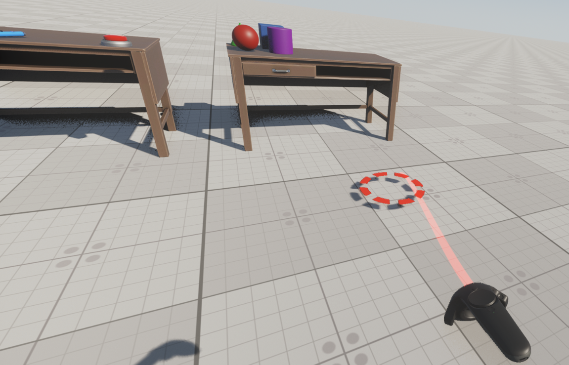

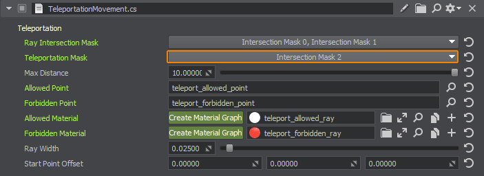

3.2. Restricting Teleportations#
Teleportation is often used to move around in VR projects (especially when the scene is large). By default, it is possible to teleport to any point of the scene. Sometimes it might be necessary to restrict teleportation to certain areas (for example, to the roof). The VR Template provides the TeleportationMovement component (assigned to the vr_layervr_movement_managerteleportation_movement node) that implements teleportation logic and allows specifying the maximum teleportation distance, the appearance of the ray and target point, and so on.

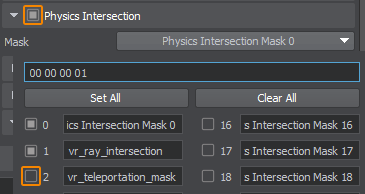

Teleporting to an object is allowed when its Physics Intersection Mask matches the Teleportation Mask in the component settings. By default, the 2nd bit of the Teleportation Mask is used. So, you can teleport to objects, for which the Physics Intersection option is enabled and the 2nd bit of the Physics Intersection Mask is set.
To restrict teleportation to a certain area, do the following:
  1. Create a new Static Mesh object by using the default plane (core/meshes/plane.mesh) or an arbitrary mesh that will define the restricted area.
  2. Place the Static Mesh in the scene just above the floor.
  3. In the Parameters window, enable the Physics Intersection option for the object and check that the 2nd bit of the Physics Intersection Mask is disabled.

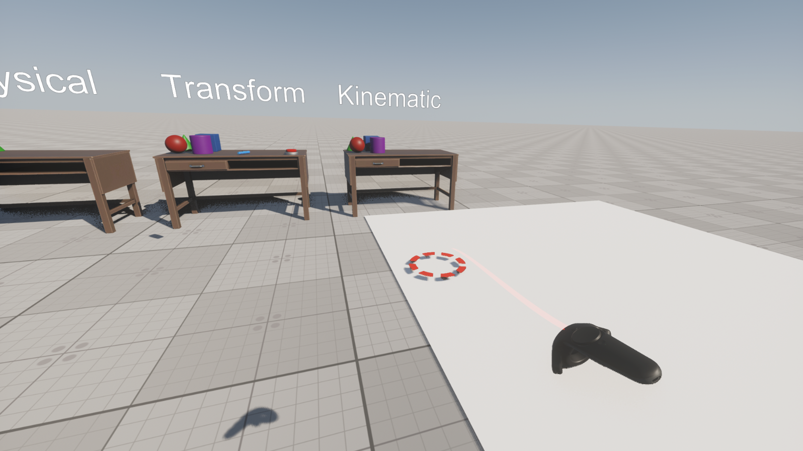

  4. Save and run the application. Now you cannot teleport to the area defined by the rectangular plane (the ray and the target point are red).

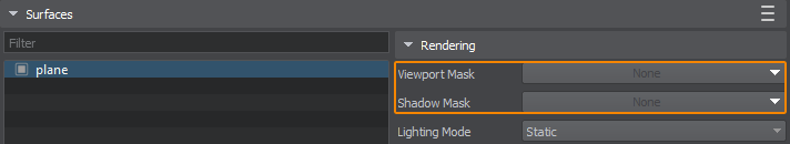

  5. To hide the Static Mesh, disable all bits of its Viewport and Shadow masks.
  6. Save changes and run the application: the rectangular plane is invisible now.

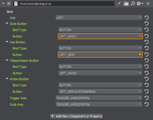

3.3. Changing Vive Controller Grip Button to Trigger#
In your VR application, you might want to remap actions or swap the controls. As an example, let's do this for the HTC Vive controller. We will remap the Use action from the Grip button to Trigger, and the Grab action to the Grip button.
User input for the Vive controller is defined in the ViveControllerInput component. It is assigned to the left_preset_0 and right_preset_0 nodes (vr_playervr_inputvive_input) in our VR sample.
To remap actions, do the following:
  1. Select the left_preset_0 node that contains settings for the left controller (the Bind → Side parameter value is set to LEFT).
  2. Change the Grab Button → Button value to LEFT_AXIS, and the Use Button → Button value to LEFT_GRIP:
  3. Select the right_preset_0 node that contains settings for the right controller.
  4. Change the Grab Button → Button value to RIGHT_AXIS, and the Use Button → Button value to RIGHT_GRIP.
  5. Save changes (Ctrl+S) and press the Play button to run the application.
Now you can grab objects by the trigger, and use them by the Grip side button.

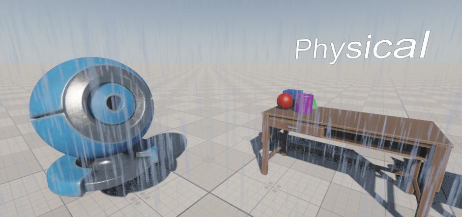

3.4. Adding an Interactive Area#
Often in games and VR applications some actions are performed when you enter a special area in the scene (for example, music starts, sound or visual effects appear). In our project, let's implement the following: when you enter or teleport to a certain area, it rains inside it.
In UNIGINE, the World Trigger node is used to track when any node (collider or not) gets inside or outside of it (for objects with physical bodies, the Physical Trigger node is used).
  1. First of all, create a trigger to define the rain area. On the Menu bar, choose Create → Logic → World Trigger and place the trigger near the Material Ball, for example. Set the trigger size to (2, 2, 2).
  2. Create a new TriggerZone component that will enable or disable the rain node (in our case, it is a particle system simulating rain) depending on the trigger state. Add the following code to the component and then assign it to the World Trigger node:
    TriggerZone.cs
    Source code (C#)
    using System;
    using System.Collections;
    using Unigine;
    [Component(PropertyGuid = "AUTOGEN_GUID")] // <-- an identifier is generated automatically for the component
    public class TriggerZone : Component
    	private WorldTrigger trigger = null;
    	public Node ControlledNode = null;
    	private void Init()
    		// check if the component is assigned to WorldTrigger
    		if (node.Type != Node.TYPE.WORLD_TRIGGER)
    			Log.Error($"{nameof(TriggerZone)} error: this component can only be assigned to a WorldTrigger.\n");
    			Enabled = false;
    			return;
    		// check if "ControlledNode" is specified
    		if (ControlledNode == null)
    			Log.Error($"{nameof(TriggerZone)} error: 'ControlledNode' is not set.\n");
    			Enabled = false;
    			return;
    		// add callbacks to be fired when a node gets inside and outside the trigger
    		trigger = node as WorldTrigger;
    		trigger.AddEnterCallback(trigger_enter);
    		trigger.AddLeaveCallback(trigger_leave);
    	private void Update()
    		// write here code to be called before updating each render frame
    	// callback function that enables ControlledNode when "vr_player" enters the trigger
    	private void trigger_enter(Node node)
    		ControlledNode.Enabled = true;
    	// callback function that disables ControlledNode when "vr_player" leaves the trigger
    	private void trigger_leave(Node node)
    		if (node.Name != "vr_player")
    			return;
    		ControlledNode.Enabled = false;
  3. Now let's add the rain effect. Drag the rain_effect.node asset (available in the vr/particles folder of the UNIGINE Starter Course Project add-on) to the scene, add it as the child to the trigger node, and disable it (it will be enabled by the component).
  4. Drag the rain_effect node from the World Hierarchy window to the Controlled Node field of the TriggerZone (in the Parameters window).
  5. Save changes (Ctrl+S), click Play to run the application, and try to enter the area defined by the trigger - it is raining inside.

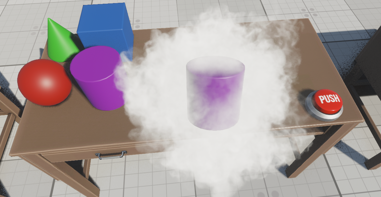

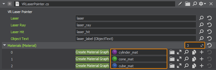

3.5. Adding a New Interaction#
Another way to extend functionality is to add a new action for the object.
Suppose we want to extend the functionality of the laser pointer, which we can grab, throw and use (turn on the laser ray) for now, by adding an alternative use action - change the material of the object being pointed at. This action will be executed when we press and hold the Grip side button on one controller while using the laser pointer gripped by the opposite controller.
The VRLaserPointer.cs component implements the base functionality of the laser pointer.
The base component for all interactive objects is VRBaseInteractable (vr_template/components/base/VRInteractable.cs). It defines all available states of the interactive objects (NOT_INTERACT, HOVERED, GRABBED, USED) and methods executed on certain actions performed on the objects (OnHoverBegin, OnHoverEnd, OnGrabBegin, OnGrabEnd, OnUseBegin, OnUseEnd).
Components inherited from VRBaseInteractable must implement overrides of these methods (for example, the grab logic for the object must be implemented in the OnGrabBegin method of the inherited component).
So, we need to add a new action and map it to a new state (the Grip side button is pressed on one controller while the laser pointer gripped (Grip) by the opposite controller is used):
  1. Add a new OnAltUse action (alternative use) and a new ALT_USED state to the VRBaseInteractable base component:
    VRBaseInteractable.cs
    Source code (C#)
    using System;
    using Unigine;
    public class VRBaseInteractable : Component
    	static public event Action<VRBaseInteractable> onInit;
    	public enum INTERACTABLE_STATE
    		NOT_INTERACT,
    		HOVERED,
    		GRABBED,
    		USED,
    		ALT_USED   // add a new state
    	public INTERACTABLE_STATE CurrentState { get; set; }
    	protected void Init()
    		onInit?.Invoke(this);
    	public virtual void OnHoverBegin(VRBaseInteraction interaction, VRBaseController controller) { }
    	public virtual void OnHoverEnd(VRBaseInteraction interaction, VRBaseController controller) { }
    	public virtual void OnGrabBegin(VRBaseInteraction interaction, VRBaseController controller) { }
    	public virtual void OnGrabEnd(VRBaseInteraction interaction, VRBaseController controller) { }
    	public virtual void OnUseBegin(VRBaseInteraction interaction, VRBaseController controller) { }
    	public virtual void OnUseEnd(VRBaseInteraction interaction, VRBaseController controller) { }
    	// add methods for a new "alternative use" action
    	public virtual void OnAltUse(VRBaseInteraction interaction, VRBaseController controller) { }
    	public virtual void OnAltUseEnd(VRBaseInteraction interaction, VRBaseController controller) { }
  2. Add overrides of the OnAltUse() and OnAltUseEnd() methods to the VRLaserPointer component (as we are going to add a new action for the laser pointer). In the Update() method, implement logic of the AltUse action that is executed when the corresponding flags are set.

  4. Specify the list of materials that will be applied to the object. Select the laser_pointer node and click Edit in the Parameters window. Then find the VRLaserPointer component, specify the number of elements for the Materials array (for example, 3) and drag the required materials from the Materials window to fill the array.

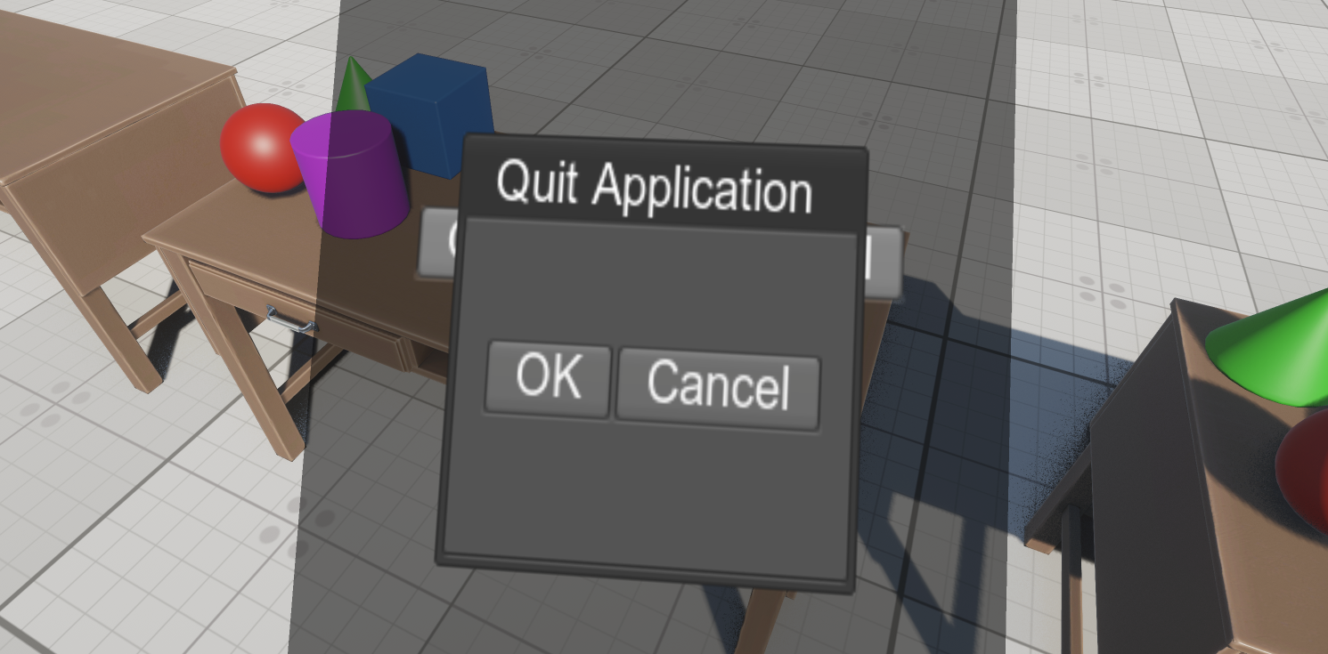

3.6. Customizing Menu#
The VR template includes 2 types of menus: the main one is attached to the HMD position, the second - to the hand. In the VR sample, the MenuAttachedToHead node (ObjectGui) is used for the main menu, and the menu node (ObjectGui) - for the additional menu. Each node is added as a child to the corresponding controller node (for example,vive_left_controller).
All menu nodes have the same VRMenuSample.cs component assigned. It is inherited from the base VRBaseUI component that implements a user interface. In general, the user interface is implemented as follows:
  1. Inherit a new component from the base VRBaseUI.
  2. Implement the user interface with the required widgets in the overriden InitGui() method.
  3. Implement callback for processing widgets events (pressing a button, selecting elements in the drop-down menu, etc.)
  4. Add the callbacks to the corresponding widgets in the InitGui() method.
  5. Assign the component to the ObjectGui node that will display the user interface.
Let's create a new menu for the left controller and add the quit button:
  1. Inherit a new component from the base VRBaseUI, call it VRHandMenu and copy the following code to it:
    VRHandMenu.cs
    Source code (C#)
    using System;
    using Unigine;
    public class VRHandMenu : VRBaseUI
    	// declare required widgets
    	private WidgetSprite background;
    	private WidgetVBox VBox;
    	private WidgetButton quitButton;
    	private WidgetWindow window;
    	private WidgetButton okButton;
    	private WidgetButton cancelButton;
    	private WidgetHBox HBox;
    	// overriden method that is called on interface initialization;
    	// it adds the required widgets and sets callbacks
    	protected override void InitGui()
    		if (gui == null)
    			return;
    		background= new WidgetSprite(gui, "core/textures/common/black.texture");
    		background.Color = new vec4(1.0f, 1.0f, 1.0f, 0.5f);
    		gui.AddChild(background, Gui.ALIGN_BACKGROUND | Gui.ALIGN_EXPAND);
    		// add a vertical column container WidgetVBox to GUI
    		VBox = new WidgetVBox();
    		VBox.Width = gui.Width;
    		VBox.Height = 100;
    		gui.AddChild(VBox, Gui.ALIGN_OVERLAP|Gui.ALIGN_CENTER);
    		// add the quit button to the container
    		quitButton = new WidgetButton(gui, "QUIT APPLICATION");
    		quitButton.FontSize = 20;
    		VBox.AddChild(quitButton);
    		quitButton.AddCallback(Gui.CALLBACK_INDEX.CLICKED, ButtonQuitClicked);
    		VBox.Arrange();
    		// create a quit confirmation window
    		window = new WidgetWindow(gui, "Quit Application");
    		window.FontSize = 20;
    		// add a horizontal row container WidgetHBox to the confirmation window
    		HBox = new WidgetHBox();
    		HBox.Width = window.Width;
    		HBox.Height = 100;
    		window.AddChild(HBox);
    		// add the "OK" button and assign the "OkClicked" callback that will close the application
    		okButton = new WidgetButton(gui, "OK");
    		okButton.FontSize = 20;
    		HBox.AddChild(okButton);
    		okButton.AddCallback(Gui.CALLBACK_INDEX.CLICKED, OkClicked);
    		// add the "Cancel" button and assign the "OkClicked" callback that will close the confirmation window
    		cancelButton = new WidgetButton(gui, "Cancel");
    		cancelButton.FontSize = 20;
    		HBox.AddChild(cancelButton);
    		cancelButton.AddCallback(Gui.CALLBACK_INDEX.CLICKED, CancelClicked);
    	// callback to be fired on clicking "quitButton"
    	private void ButtonQuitClicked()
    		gui.AddChild(window, Gui.ALIGN_OVERLAP | Gui.ALIGN_CENTER);
    	// callback to be fired on clicking "cancelButton"
    	private void CancelClicked()
    		gui.RemoveChild(window);
    	// callback to be fired on clicking "okButton"
    	private void OkClicked()
    		// quit the application
    		Engine.Quit();
  2. Assign the VRHandMenu.cs component to the menu node (the child of the vive_left_controller node).
  3. Save changes (Ctrl+S) and click Play to run the application.
3.7. Adding a New Interactable Object#
Let's add a new type of interactable object, that we can grab, hold and throw (i.e. it will be inherited from the VRBaseInteractable component) with an additional feature: some visual effect (for example, smoke) will appear when we grab the object, and it will disappear when we release the object. In addition, it will display certain text in the console, if the corresponding option is enabled.
  1. Create a new VRObjectVFX component and add the following code to it:
    VRObjectVFX.cs
    Source code (C#)
    using System;
    using Unigine;
    public class VRObjectVFX : VRBaseInteractable
    	// an asset with an effect that occurs when the object is grabbed
    	public AssetLinkNode vfx_node = null;
    	private Node vfx = null;
    	private Unigine.Object obj = null;
    	// this method is called for the interactable object each frame
    		// update transformation of the effect if the object is grabbed
    		if(CurrentState == VRBaseInteractable.INTERACTABLE_STATE.GRABBED)
    		vfx.WorldTransform = node.WorldTransform;
    	// this overriden method is called after component initialization
    	// (you can implement checks here)
    	protected override void OnReady()
    	// check if the asset with the visual effect is specified
    	if (vfx_node == null)
    			Log.Error($"{nameof(VRObjectVFX)} error: 'vfx_node' is not assigned.\n");
    			Enabled = false;
    			return;
    	else
    			vfx = vfx_node.Load();
    			vfx.Enabled = false;
    	// this overriden method is called when grabbing the interactable object
    	public override void OnGrabBegin(VRBaseInteraction interaction, VRBaseController controller)
    		// show the effect
    		vfx.Enabled = true;
    		// set the current object state to GRABBED
    		CurrentState = VRBaseInteractable.INTERACTABLE_STATE.GRABBED;
    	// this overriden method is called when releasing the interactable object
    	public override void OnGrabEnd(VRBaseInteraction interaction, VRBaseController controller)
    		// hide the effect
    		// set the current object state to NOT_INTERACT
    		CurrentState = VRBaseInteractable.INTERACTABLE_STATE.NOT_INTERACT;
  2. Assing the VRObjectVFX.cs component to the cylinder node (the child of the kinematic_movable dummy node).
  3. Drag the vr/particles/smoke.node asset to the Vfx Node field. This node stores the particle system representing the smoke effect. It is available in the vr/particles folder of UNIGINE Starter Course Projects add-on.
  4. Save changes (Ctrl+S) and press the Play button to run the application.
Now if you grab and hold the cylinder, it will emit smoke:
