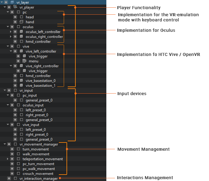

When you first open your project based on the VR Template and see a lot of different classes and components, you might get confused a bit. So let's learn a bit more about the template structure. All components that implement the basic VR functionality are assigned to the corresponding nodes organized in the hierarchy with the vr_layer root node (see the picture below):

A player is represented by the hierarchy of nodes with the vr_player node in the root (a Player Dummy camera), to which the VRPlayer component is assigned. The component implements player's logic. The child nodes of vr_player represent models of HMDs and controllers, to which all necessary components are assigned to configure interactions and main parameteres.

VRInput is the main component that implements operations on user input, it includes all available devices, controllers, controls (controllers + common ones), event handlers, an so on. Input parameters for each type of devices, functionality for polling the status of controls, etc. are implemented in the corresponding classes (PCInput, ViveInput, OculusInput).

The VRMovementManager component is used for movement management. Different types of movements (rotating, walking, teleporting) are implemented in the components inherited from the base VRBaseMovement component (TurnMovement, WalkMovement, TeleportationMovement + implementation of movements for the VR-emulation mode with keyboard control).
