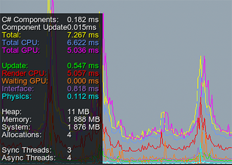

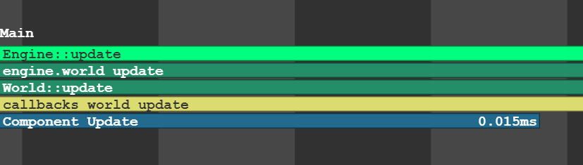

Using Microprofile For Application Logic#
You can use the Microprofile to inspect performance of your application logic.
- Open the source code of your application.
- Find a function or a scope in the code you want to inspect.
In the beginning of the function (or the scope), call Profiler.Begin(). Specify a name for the capture to be displayed in the Microprofile.
NoticeYou can specify the __FUNCTION__ macro to automatically use the class and the function name as the capture. -
In the end of the function, call Profiler.End().
Microprofile.csprivate void Update() { // start profiling Profiler.Begin("Component Update"); float time = Game.Time; Vec3 pos = new Vec3(MathLib.Sin(time) * RADIUS, MathLib.Cos(time) * RADIUS, 0.0f); trigger.Enabled = pos.x > 0.0f || pos.y > 0.0f; trigger.WorldPosition = pos; // stop profiling Profiler.End(); }
- Run the project.
- Open the console and run the microprofile_enabled 1 command.
- Go to the Microprofile and find the region with the specified name.
The Begin() and End() functions make the profiling scope available for both the Profiler and the Microprofile.
