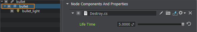

  4. Drag programming_quick_start\character\bullet\bullet.node from the Asset Browser into the Viewport and click Edit in the Reference section of the Parameters window to make modifications. Add a Destroy component to the child ObjectMeshStatic bullet node and set the Life Time to 5.0.

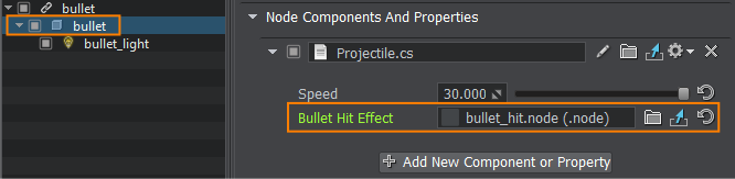

  7. Then, add a Projectile component to the child ObjectMeshStatic bullet of the bullet Node Reference. Assign the bullet_hit node from the Asset Browser window to the Bullet Hit Effect field.
