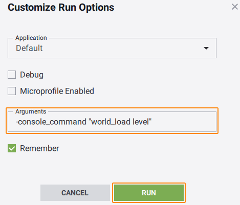

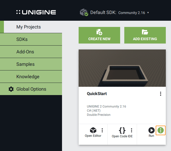

  2. To customize running options (change the default world to be loaded to our world named level) click the ellipsis next to the Run button in the SDK Browser.
    Then add the following line to the Arguments field:
    Source code
    -console_command "world_load level"
    And click RUN to run the game with the scene we've just set up.
