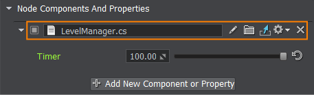

  3. Create a new Dummy Node called "level_manager" and place it somewhere in the world.
  4. Add the LevelManager component to the level_manager node.

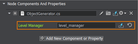

  3. Select the object_generator node in the World Nodes window and drag the level_manager node to the corresponding field of the ObjectGenerator component.
  4. Save changes to the world, go to File->Save World or press Ctrl+S hotkey. Then run the game to see the game rules in action.
