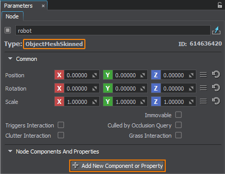

  2. Select the robot node (ObjectMeshSkinned), then click Add New Component or Property in the Parameters window and assign the PlayerController component.
    Make sure you assign the component to the ObjectMeshSkinned node inside the NodeReference!
