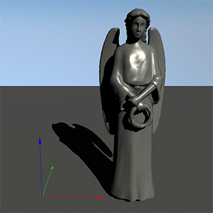

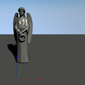

The result will be different. The pictures below show the difference (camera is located at the same place).
Order: rotation and translation
Order: translation and rotation
The pictures above show the position of the meshes related to the world origin.

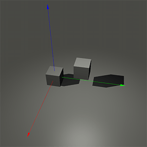

Parent origin is the same with the world origin
Parent origin has been moved and the child origin has also been moved
Pictures above show the main point of the matrix hierarchy. When the parent origin (node) is moved, the chlld origin will also be moved and the local transformation matrix of the child would not be changed. But the world transformation matrix of the child will be changed. If you need the world transformation matrix of the child related to the world origin, you should use the getWorldTransform(), setWorldTransform() functions; in case, when you need the local transformation matrix of the child related to the parent, you should use the getTransform(), setTransform() functions.

As you see, the local transformation matrix remains the same but the world transformation matrix has been changed. This means that the second node has the same position relative to the first, but another position relative to the world origin because the position of the parent node has been changed.
Parent node's origin coincides with the world origin
Parent node has been moved and child node has also been moved automatically
