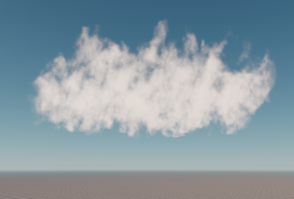

The volume_cloud_base material is used to create clouds or shaped fog. It is applied to Volume Box objects.
Volume Cloud Material

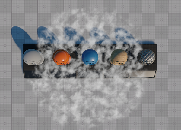

Soft Interaction#
Enables soft interaction for volume boxes and other objects, so that the interactions would not be sharp and cause artifacts. A volume object fades out to the intersection plane: the color of the volume box and the object is smoothly interpolated in case they are approximately of the same depth value.

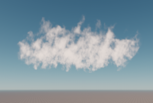

Jitter#
This parameter determines smoothness of the cloud with a small number of samples. The higher the value, the smoother the cloud is.
