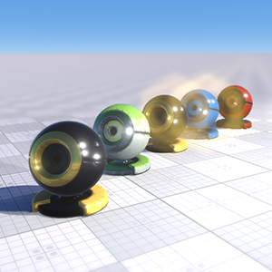

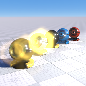

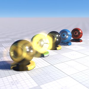

Threshold Brightness threshold used to determine areas to be illuminated:
  • By the minimum value of 0, the bright areas can become overexposed.
  • The higher the value, the fewer objects are bright enough to be illuminated.
Threshold = 0.6
Threshold = 1.2

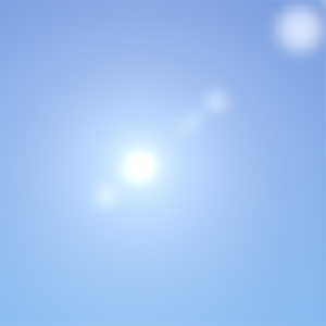

Lens
The parameters described below are available only when lens flares are enabled (Rendering -> Lens).
Lens flares
Color The color of lens flares.
Scale A multiplier for a color of lens flares.
Scale = 0.25
Scale = 0.5
Length Length indicating if the whole radial lens flare is rendered on the screen or only a part of it. This option controls how lens flares pattern is distributed.
Radius A radius of the spherical lens flares on the screen.
Radius = 0.07
Radius = 0.1
Threshold The brightness threshold for areas to produce flare:
  • The higher the threshold value, the brighter the area should be to produce flare.
