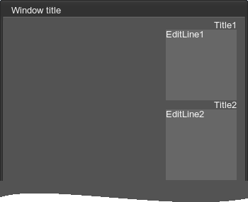

align
Unlike the align attribute of the texttag, thealign tag can be applied to a group of widgets.
Attributes:
  • align
    Acceptable values are center, left, right.
For example:
Source code (XML)
<align align="right">
	<label><text>Title1</text></label>
	<edittext name="Test::edittext_1" export="1" width="100" height="100">
		<text>EditLine1</text>
	</edittext>
	<label><text>Title2</text></label>
	<edittext name="Test::edittext_2" export="1" width="100" height="100">
		<text>EditLine2</text>
	</edittext>
</align>
All of the elements inside the align tag are right-aligned:
