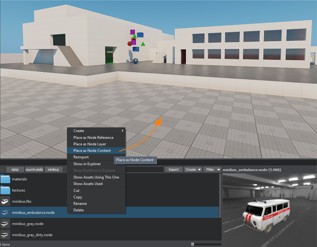

    A minibus vehicle model has the body frame as the parent node and its wheels as child nodes.
  4. In the Asset Browser, right-click on a minibus node you like the most and choose Place as Node Content. Place the vehicle on the ground in the world. As we don't plan to use multiple instances of the car, we simply put all its parts directly to the scene, without the NodeReference container.

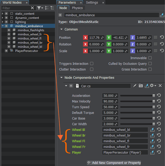

  2. In the Editor, assign wheels (ObjectMeshStatic nodes) and the camera (PlayerPersecutor node) to the corresponding fields of the Car component as specified below.
Congratulations! Now you can finally drive the car around the world. If the current physics of the car is not suitable for your needs, you can always fine tune the parameters of the wheel joints and achieve the results you need. Also, see the Basic Programming How-To Livestream for the hands-on vehicle implementation and discussions. The full source code of the Car component is given below.
