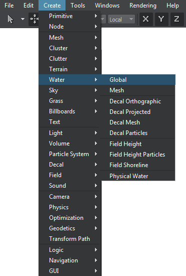

To add infinite water to the scene via UnigineEditor:
  1. On the Menu bar, click Create -> Water -> Global:
  2. Place the water object in the scene:
Infinite water will be added to the scene and you will be able to edit it via the Parameters window.
