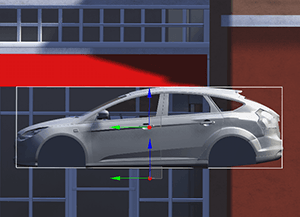

  6. Add the Box shape to the node and specify the size and the position of the shape. Physics of the world has influence on the added shape that is why you should specify shape boundaries close to the boundaries of the car body mesh.
    Correct shape size and position
    Incorrect shape size and position
