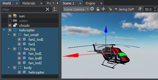

  1. Create the base hierarchy. Prepare the base hierarchy that will represent your object. For example, if you want to use a helicopter repeatedly in your world, assemble a hierarchy of nodes with materials, animations, logic components, and everything else that you need.

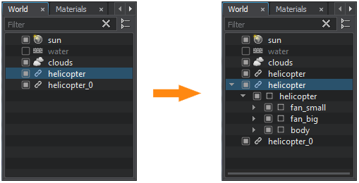

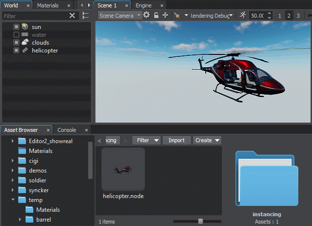

  2. Convert the node hierarchy into a Node Reference. Simply drag and drop the root node of the hierarchy to the desired folder in Asset Browser. A corresponding *.node (template) asset containing the hierarchy will be created in the folder. The node hierarchy in the world will be replaced by a reference to this asset.
  3. Place instances. The first instance in the world is the one that replaced the hierarchy when you dragged it into Asset Browser. You can add other instances by dragging the desired *.node template from Asset Browser directly to the scene or by cloning the Node Reference like any other node (Shift+Drag).

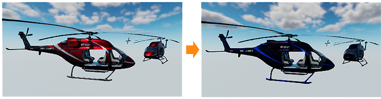

When you edit any instance and save the changes, the template and all other instances are automatically updated. This approach ensures integrity when changing the parameters of reusable objects, especially if they are complex. This process looks as follows:
  1. Select any instance in the world through the Editor Viewport or World Nodes Hierarchy window. The Node Reference parameters will be displayed in the Parameters window.
  2. Click Edit. The hierarchy of the original Node Reference will be displayed in the World Nodes Hierarchy window.
  3. Edit the source Node Reference. You can make any changes: change materials, add new nodes, delete existing nodes, etc.
  4. Click Apply to save your changes or Cancel to discard them. The changes will be applied to all instances at once.

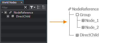

The transformation of Node Reference is not affected by the transformation of the nodes stored in it. Thus, logic-driven and physics-driven nodes inside Node Reference will make no influence on its direct children.
In the following example, the moving grouped Node_1 and Node_2 nodes (e.g. driven by physics) contained by a Node Reference will not change the transformation of the Node Reference and, therefore, the DirectChild node will not be affected as well.
Schematic representation of Node Reference content
So, it is recommended to enclose all interconnected nodes in a single Node Reference to ensure logical and hierarchical integrity.
