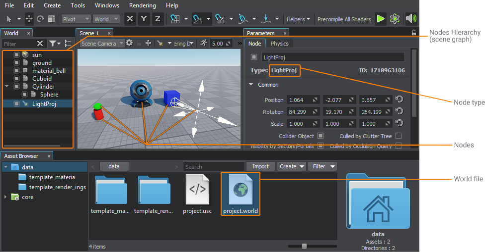

A UNIGINE-based virtual world is a 3D scene that contains a set of different scene graph nodes (e.g. static meshes, lights, cameras, etc.) placed into specified positions, and global settings (rendering, physics, etc.) applied to the whole scene.
In terms of UNIGINE, all objects added to the scene are called nodes. Nodes can be of different types, determining their visual representation and behavior. All nodes are arranged into a hierarchy: there are parent and child nodes; one node can have several child nodes. A scene graph in UNIGINE is a multi-root tree (hierarchy) of nodes. Each world is represented by an XML file with the *.world extension.
To edit your existing worlds and create new ones, use UnigineEditor. You can create and use as many worlds as you need.
Viewing the world and its nodes in UnigineEditor

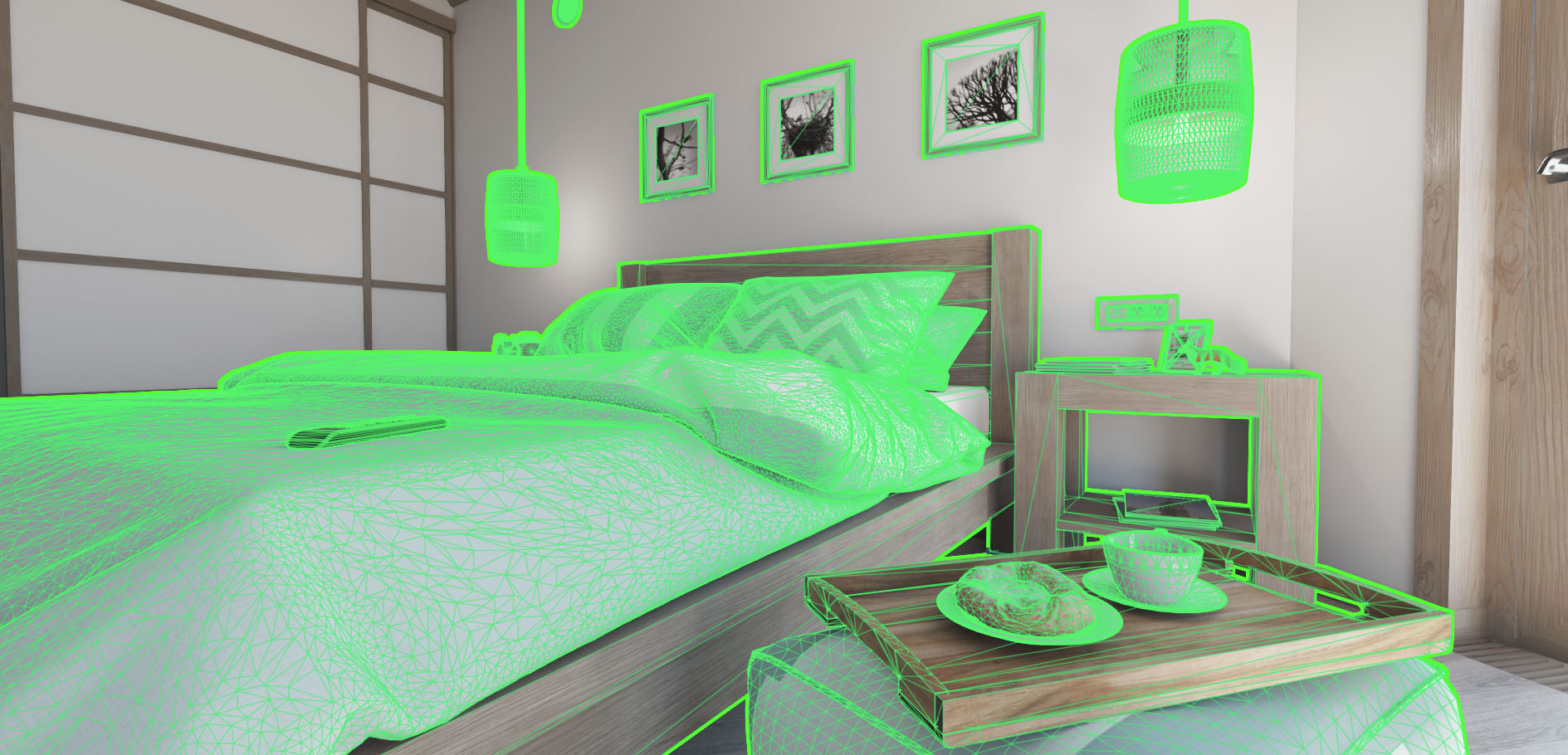

Static Mesh is an object consisting of polygons that define its geometry. This geometry is stored in the *.mesh file and is always unchanged. Usually Static Mesh is used to create static geometry, such as buildings or furniture. The geometry of such objects is created in third-party 3D editors and then imported into the engine. In addition to Static Mesh, there are two other similar objects used in specific cases:
  • Dynamic Mesh is an object the geometry of which can be modified procedurally. As a rule, such modification is required to change the object shape as a result of some external impact (clash, explosion) or to create dynamically changing surfaces (fabric, wire, liquid, etc.).

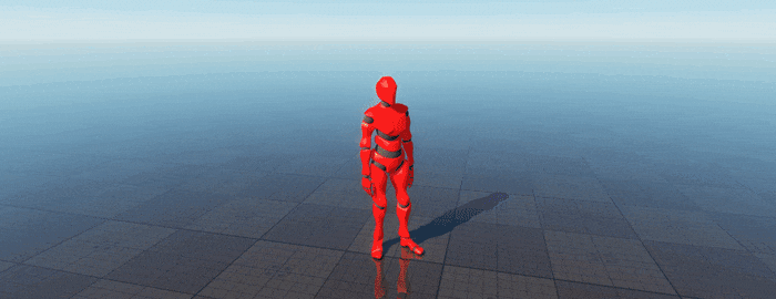

  • Skinned Mesh is an object used to create characters with skeletal animation or animation based on a set of distorted versions of an object (morph targets or blend shapes). In addition to geometry, it contains animation data.

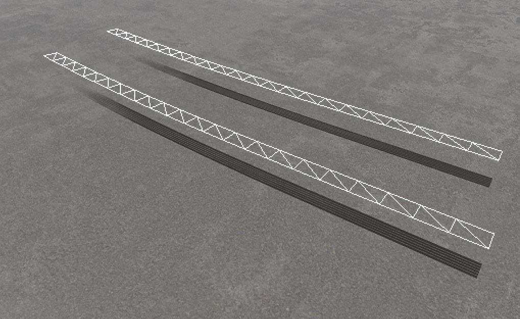

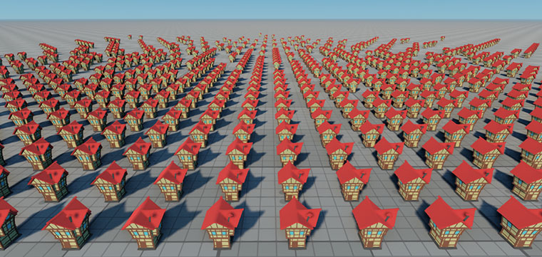

  • Mesh Cluster is an object that can contain a great number of identical meshes placed around the scene as you see fit. Mesh Cluster manages these meshes as one object, but their position, rotation, and scale can be changed manually. This object is usually used to place multiple identical objects, for example, houses in a neighborhood. Identical mesh objects can be baked to Mesh Cluster manually or in semi-automatic mode.

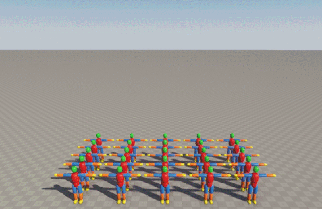

  • Mesh Clutter is an object that contains identical meshes. However in this case meshes are positioned randomly and cannot be managed manually. Mesh Clutter is used to fill the scene with vegetation (for example, to create a forest) or place identical objects (leaves, branches, garbage). Areas where meshes can be placed are defined by specific masks.

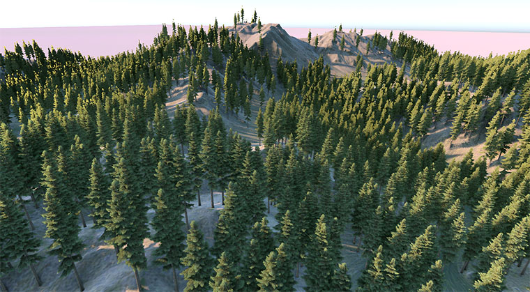

Landscape Terrain#
Landscape Terrain
UNIGINE has Landscape Terrain, which is used to create a virtually infinite arbitrary landscape with high level of detail, optimized performance, and flexible settings. It supports collaborative editing and the ability to modify the surface in real time (creating craters, explosion funnels, and trenches). The Landscape Terrain object consists of individual layers (Landscape Layer Map), each storing the data used for rendering (elevation, imagery, and masks). These layers are blended to create a realistic landscape. You can draw a landscape from scratch in the Editor or use data generated in a third-party application.
You can also use the Terrain Global object to create a landscape — it has specific features and is mainly used for flight simulators. We are not going to review this object in the course.

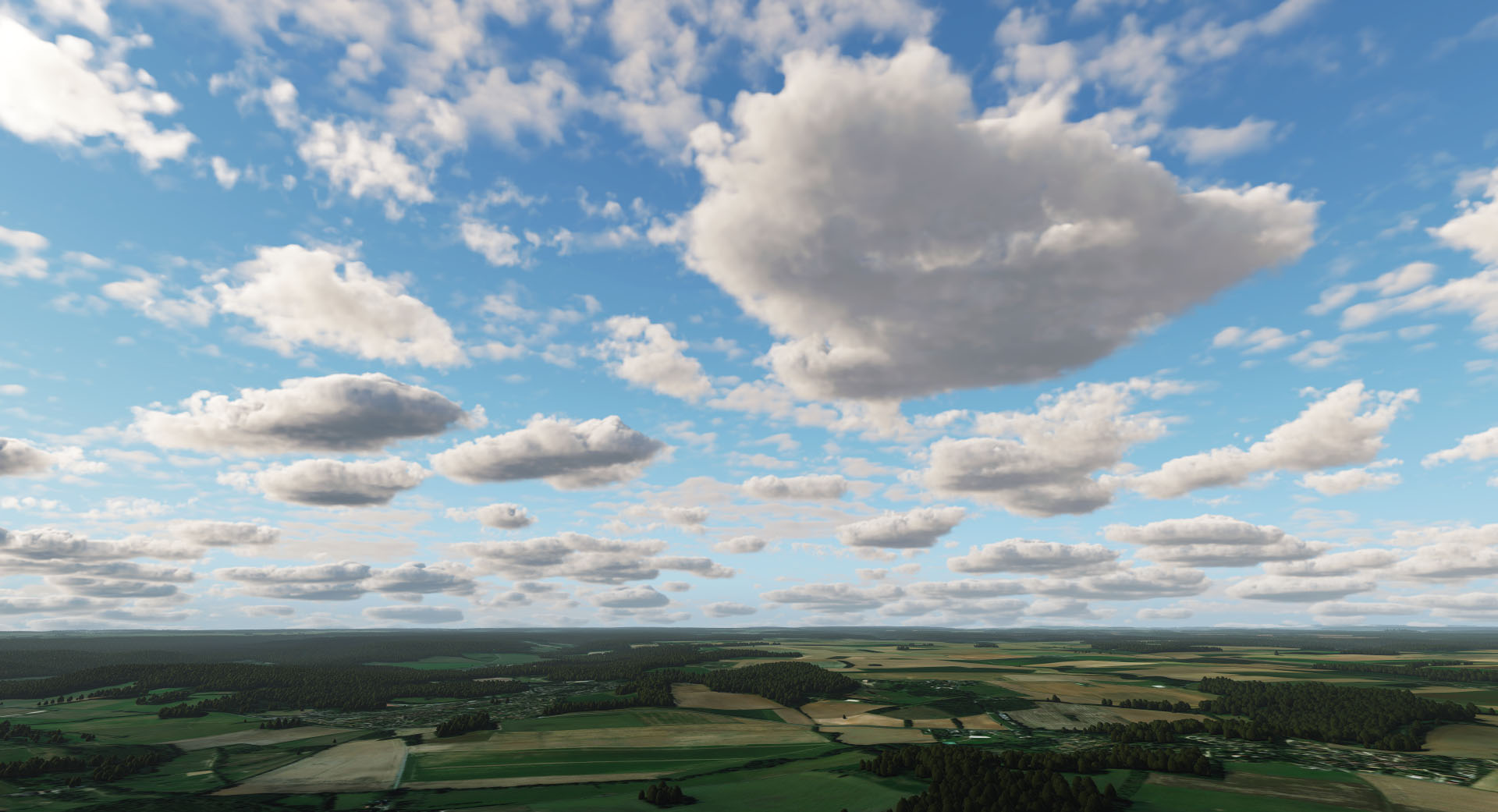

This object is used for simplified simulation of the planet's atmosphere. It is modelled as an upper hemisphere of the specified color with dynamic clouds generated using a special texture.
Cloud Layer#
Cloud Layer
This object allows generating layers of volumetric clouds that drift across the sky, with realistic lighting, shadow casting, and interactivity.
It supports the 10 basic types of clouds that exist in nature (cumulus, cirrus, etc.), which are available as customizable presets, and you can simultaneously add several different layers at different heights. Support for the Earth's curvature is also available to make the cloudy sky conform to the planet's shape.

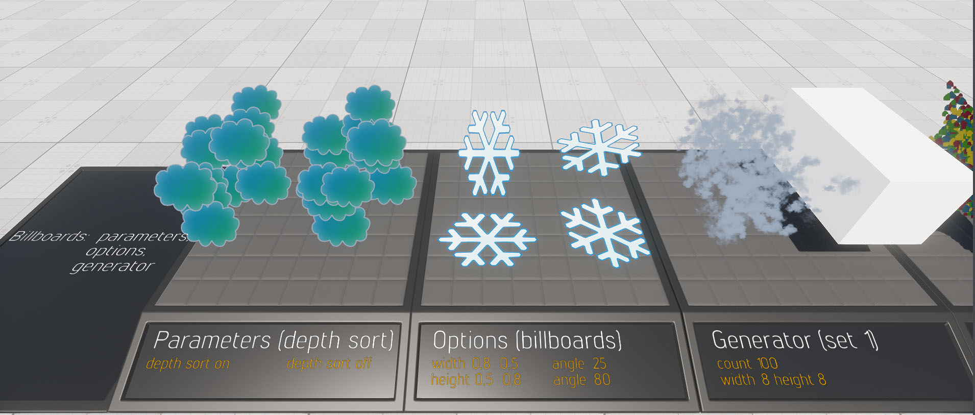

Billboard is a rectangular flat object that always faces the camera. The Billboards object consists of a number of such billboard elements. It is used instead of fully functional objects that are barely seen from far off and slightly change their position when the camera moves around them (such as stars, clouds, or trees at a distance). Using Billboards helps to speed up rendering.
Depending on its purpose, a Billboards object can be of either of three types (Base, Impostor, or Cloud) and is assigned a corresponding material. Materials differ in a set of parameters and are displayed in different ways.

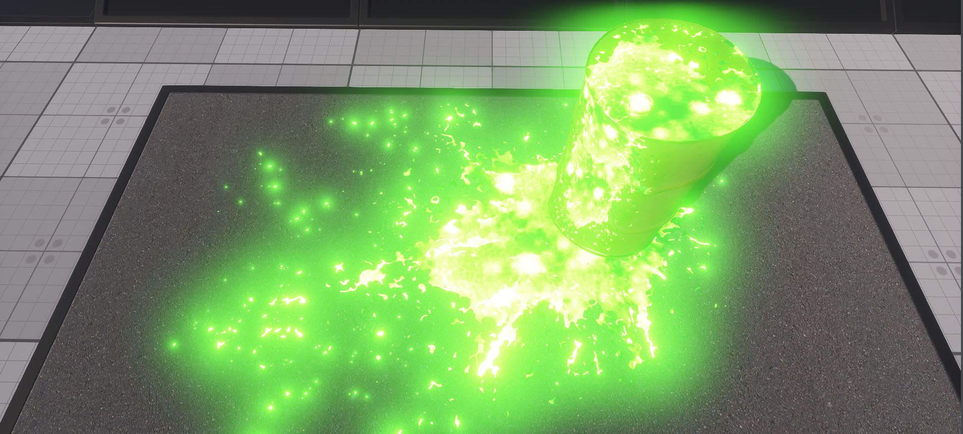

  • Particle system is a complex object consisting of an emitter, particles, and additional physical forces affecting the particles. It is used to create fire, smoke, fireworks, fountains, snow, rain, etc. We will review this node type in more detail later.

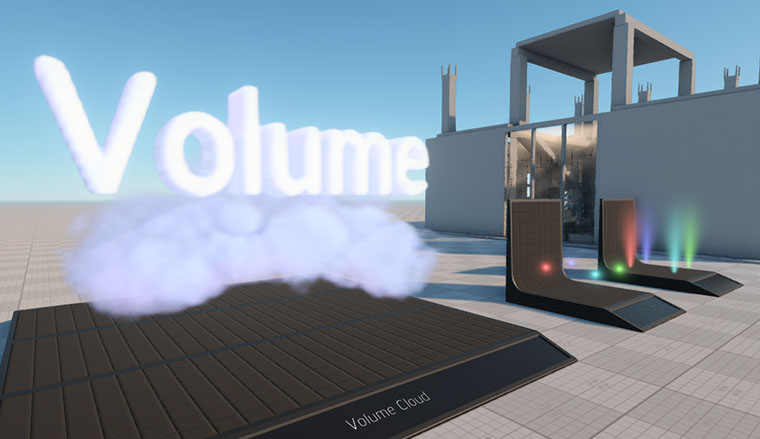

  • Volumetric objects are used to create volumetric effects (fog, clouds, sun rays, etc.):
    • Volume Box creates a volumetric effect of rectangular shape: fog, clouds, rays of light from the sun.
    • Volume Sphere creates a spherical or ellipsoidal volumetric effect such as fog, haze, or glow around point light sources (candles, lamps, etc.).
    • Volume Omni creates a visible volume of light emitted from a flat surface (e.g. flat wall and ceiling lamps).
    • Volume Projected creates light rays from directional light sources (car headlights, spotlights).
    Volumetric objects

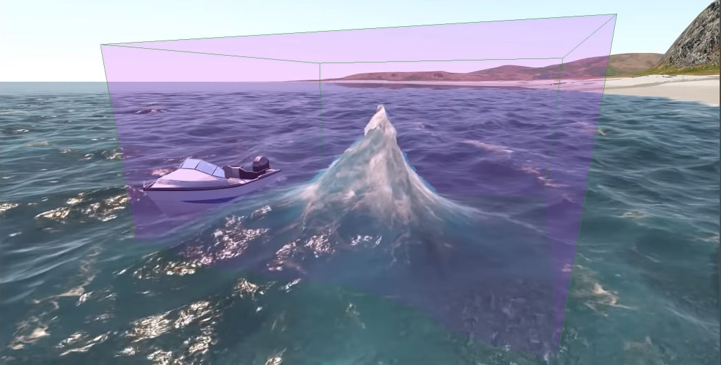

    • Field Height defines areas of Global Water where the water level should change due to external effects (e.g. to create a wake or water disturbance near certain objects).

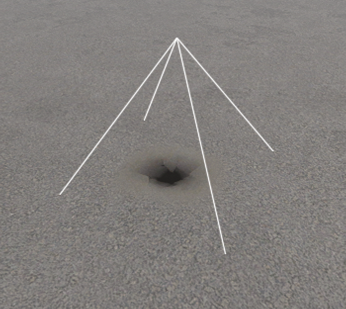

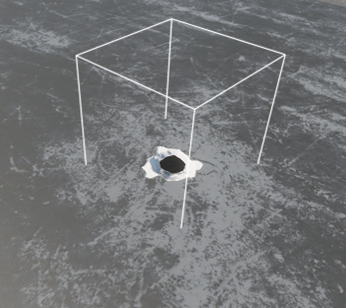

Decal is a material projection on the surface. Decals allow adding details — they help imitating holes, stains, traces, puddles, etc. Decals can also be projected onto the water surface and used to create holes in the landscape.
There are three types of decals in UNIGINE:
  • Orthographic Decal is a decal projected onto a surface using orthogonal projection. Its size is independent of the distance to the surface on which it is projected. This decal follows the shape of any surface, so it looks realistic.
  • Projected Decal is a decal projected onto a surface using perspective projection. The decal size increases as the distance to the surface increases. Projected Decal forms a projection pyramid, the size of which can be adjusted using the settings.
  • Mesh Decal is a decal that projects arbitrary geometry onto the surface using orthogonal projection. This type of decal is suitable for creating large objects with complex shapes (e.g. an entire airfield).
