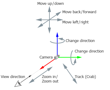

You can freely move around the scene: move the camera, change the direction (horizontally and vertically), move the camera in a plane perpendicular to the view direction, and zoom in/out.
Movements can also be linked to a reference point, which can be set by focusing the camera on a selected object or group of objects. In this case, you can rotate the camera and control zooming in/out relative to the current focus (when the focus is off, the reference point coincides with the camera position).
In addition to common terms (e.g. Move Left, Move Up, etc.), the following terms are used in the Editor:
  • Pivot means to change the yaw/pitch angle to rotate the camera around the vertical/horizontal axis respectively.
  • Tracking (Crab) means moving the camera in a plane perpendicular to the direction of view.

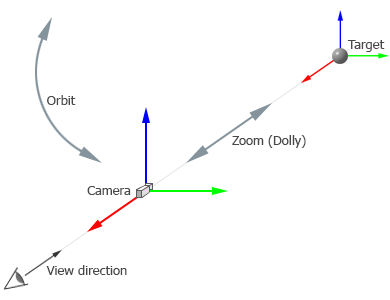

  • Orbit means rotation around the target point.
  • Zoom (Dolly) means bringing the camera closer to or away from the target point so that the camera cannot continue zooming when it reaches the target point.

Navigation controls used to move the camera freely around the scene
Additional navigation controls used to move the camera relative to the focus point
