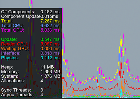

Using Microprofile For Application Logic#
You can use the Microprofile to inspect performance of your application logic.
- Open the source code of your application.
- Find a function or a scope in the code you want to inspect.
- In the beginning of the function (or the scope), call Profiler.Begin(). Specify a name for the capture to be displayed in the Microprofile.
NoticeYou can specify the __FUNCTION__ macro to automatically use the class and the function name as the capture.
- In the end of the function, call Profiler.End().
Microprofile.cs
private void Update() { // start profiling Profiler.Begin("Component Update"); float time = Game.Time; Vec3 pos = new Vec3(MathLib.Sin(time) * RADIUS, MathLib.Cos(time) * RADIUS, 0.0f); trigger.Enabled = pos.x > 0.0f || pos.y > 0.0f; trigger.WorldPosition = pos; // stop profiling Profiler.End(); }
- Run the project.
- Open the console and run the microprofile_enabled 1 command.
- Go to the Microprofile and find the region with the specified name.
The Begin() and End() functions make the profiling scope available for both the Profiler and the Microprofile.
If you want to use the Microprofile only, create the counter via the Profiler.BeginMicro() and Profiler.EndMicro() functions.
