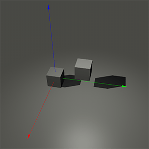

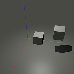

Here is an example which demonstrates different positions of the local origin related to the world origin.
Translation * Rotation order
Rotation * Translation order
On the left picture, the local origin was translated first and then rotated; on the right picture, the local origin was rotated first and then translated. All values (rotation angle, translation vector) are the same, but the result is different.

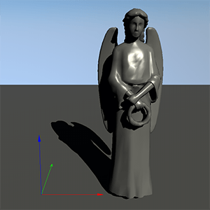

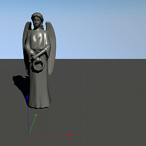

The result will be different. The pictures below show the difference (camera is located at the same place).
The pictures above show the position of the meshes related to the world origin.
