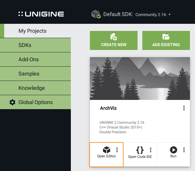

  • Create a new empty C++ project. Open the SDK Browser, go to the My Projects tab, and click the Create New button.创建 C++空项目:打开SDK浏览器,进入 My Projects(我的项目)标签页,并点击 Create New(创建新项目)按钮。
  • In the window that opens, be sure to select C++ (Visual Studio 2015+) from the API + IDE list and click Create New Project.在弹出窗口中务必从API + IDE列表选择C++ (Visual Studio 2015+),然后点击 Create New Project(创建新项目)。
  • Once the new project is created, it will appear on the My Projects tab. Click Open Editor under the created project to open it in UnigineEditor.项目创建完成后将显示在 My Projects(我的项目)列表中。点击对应项目下的 Open Editor(打开编辑器)按钮启动UnigineEditor。
