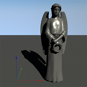

Here is an example which demonstrates different positions of the local origin related to the world origin.
Translation * Rotation order
Rotation * Translation order
On the left picture, the local origin was translated first and then rotated; on the right picture, the local origin was rotated first and then translated. All values (rotation angle, translation vector) are the same, but the result is different.

The result will be different. The pictures below show the difference (camera is located at the same place).
The pictures above show the position of the meshes related to the world origin.

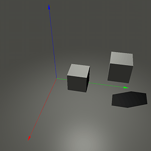

Matrix Hierarchy
Another important concept is a matrix hierarchy. When a node is added into the world as a child of another node, it has a transform matrix that is related to the parent node. That is why the Node class has different functions: getTransform(), setTransform() and getWorldTransform(), setWorldTransform() that return the local and the world transformation matrices respectively.
If the added node has no parent, this node uses the World transformation matrix.
What is the reason of using matrix hierarchy? To move a node relatively to another node. And when you move a parent node, child nodes will also be moved, that is the point.
Parent origin is the same with the world origin
Parent origin has been moved and the child origin has also been moved
Pictures above show the main point of the matrix hierarchy. When the parent origin (node) is moved, the chlld origin will also be moved and the local transformation matrix of the child would not be changed. But the world transformation matrix of the child will be changed. If you need the world transformation matrix of the child related to the world origin, you should use the getWorldTransform(), setWorldTransform() functions; in case, when you need the local transformation matrix of the child related to the parent, you should use the getTransform(), setTransform() functions.

transformation matrix of the child node: dmat4: (1 0 0 0) (0 1 0 0) (0 0 1 0) (0 2 1 1)
world transformation matrix of the child node: dmat4 (1 0 0 0) (0 1 0 0) (0 0 1 0) (2 4 3 1)
As you can see, the local transformation matrix remains the same but the world transformation matrix has been changed. This means that the second node has the same position relatively to the first, but it has another position relatively to the world origin because the position of the parent node has been changed.
Parent node has the same origin with the world origin
Parent node has been moved and the child node has also been moved automatically
