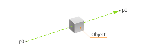

Object engine.world.getIntersection(vec3 p0, vec3 p1, int mask, int[] exclude, Variable value)
Performs tracing from the p0 point to the p1 point to find the list of objects intersecting the line. This function detects intersection with surfaces (polygons) of meshes. An intersection can be found found only if an object is matching the intersection mask.
Intersections with the surface can be found only if the following conditions are fulfilled:
  1. A per-surface Intersection flag is enabled.
  2. An Intersection option of the property in the Properties window is enabled.
  3. A surface is enabled.
  4. A surface has an assigned material.
  5. A surface has an assigned property.

Object engine.world.getIntersection(vec3 p0, vec3 p1, int mask, Variable value)
Performs tracing from the p0 point to the p1 point to find the nearest object which intersects the line. This function detects intersection with surfaces (polygons) of meshes. An intersection is found only if an object is matching the intersection mask.
