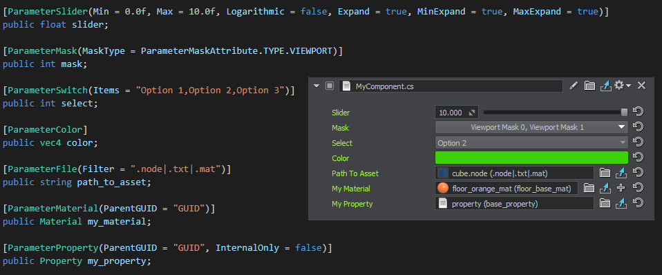

As we have already mentioned, to implement logic and control processes in components, you may need additional parameters that can be displayed in the editor so that the user can change them.
In our simple example, let's add a field (parameter) to the component to specify the rotation angle that will define how fast the object rotates. To do this, replace the constant value with the angle parameter in the line where rotation is set:
node.Rotate(0.0f, 0.0f, angle);
And add the following line before the Init() method to define the parameter:
public float angle = 0.1f;
For all public fields of the component class the user interface is automatically generated in the Editor based on the data type and attribute set, if it is necessary to display private and protected fields, it is enough to add the [ShowInEditor] option.
Let's save the changes again and switch to the Editor. Now the Parameters window for our component shows the Angle parameter, with a default value of 0.1, which can be changed.
You can use multiple attributes of various types when defining parameters. See the documentation for the detailed information about supported parameter types and attributes described in the Component class.
