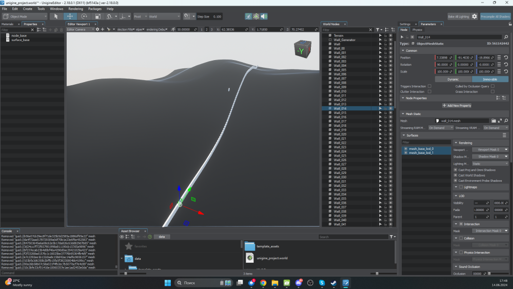

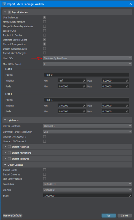

jsahir Posted June 14 Author Share Posted June 14 (edited) Hi @arizmenda! I wasn't very precise with my explanation of the problem, I'm sorry about that. The crash only happens with LODs turned on. (I attached a screenshot of my import files + the .meta file) Wall.fbx.meta Edited June 14 by jsahir didn't do the tagging right Link to comment
arizmenda Posted June 14 Share Posted June 14 Yes, we successfully reproduced the bug. For some reason crash occurs when the default prefixes are used. We managed to avoid crash by changing prefixes when importing the model as in video attached. For example _lod_0 to _lod0 We are planning to fix this issue in following update, will this suit you? 2024-06-14 15-48-58.mp4 Link to comment
jsahir Posted June 14 Author Share Posted June 14 Hi! That doesn't seem to have fixed the issue. I tried renaming my wall pieces like you recommended. Importing works only with an invalid postfix name. Renaming it to the correct one results in a crash. If I place my "wrongly" imported fbx in my world I don't get the LOD state in the outliner. If I only import one single part of the wall, it works fine however. Is it maybe a problem with instancing? Link to comment

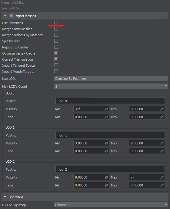

arizmenda Posted June 14 Share Posted June 14 Quote Is it maybe a problem with instancing? Try to remove Use Instances check mark when importing a model. Will there be changes? Link to comment
jsahir Posted June 14 Author Share Posted June 14 Thanks for your fast reply! Yeah that works for the LODs! I think I didn't really explain the results I want. The editor is still not using instances, I have separate meshes for each iteration of the wall. I would like to use only one mesh, the single wall part, as an instance, but with two LOD levels at the same time :D That doesnt seem to work though. Link to comment

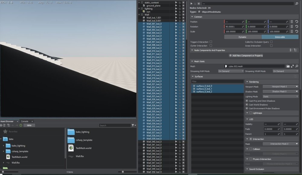

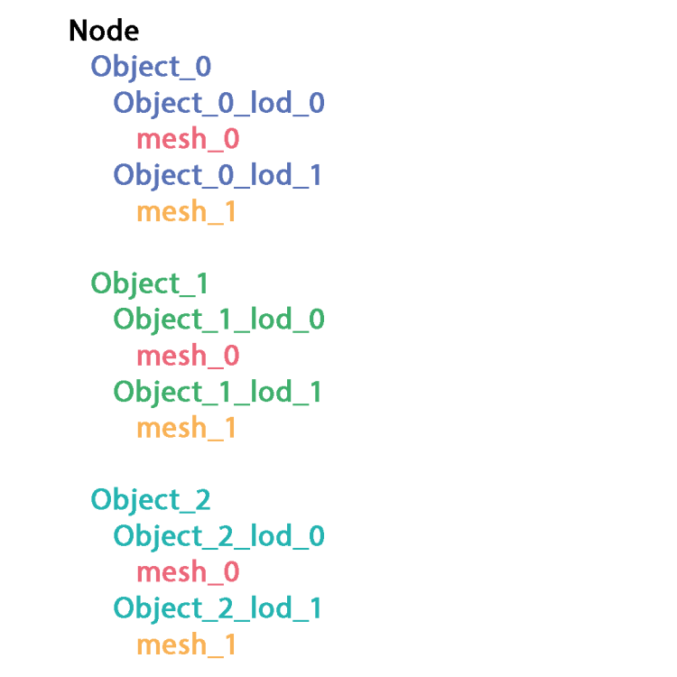

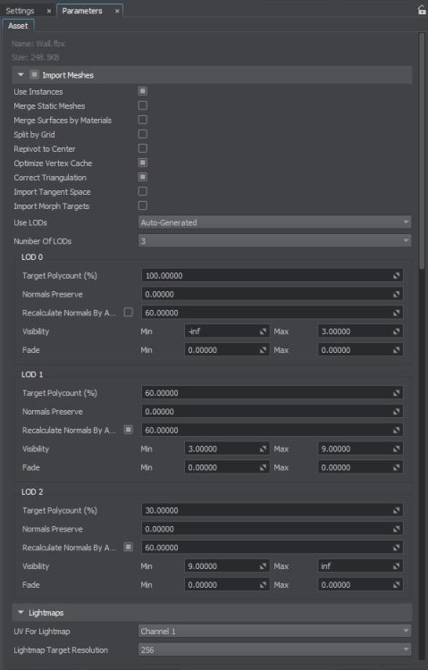

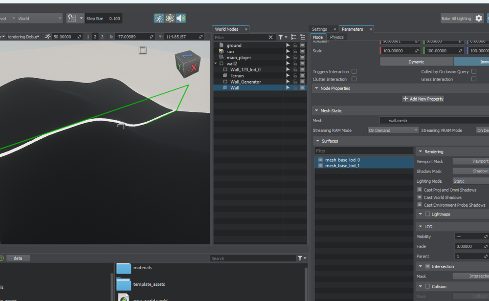

jsahir Posted Monday at 01:43 PM Author Share Posted Monday at 01:43 PM Hi! Thanks for your continued help, I think we're still not on the same page unfortunately. The end result that I would like to achieve is a mesh cluster with LODs. Using auto-genarated LODs, I get instances with the same mesh, but I would like to use my own LODs for better control. So if working with instances and LODs in the same node is possible with auto generated LODs, shouldn't it be possible with my own? So as an easy example I have six objects: Object_0_lod_0, Object_1_lod_0, Object_2_lod_0, Object_0_lod_1, Object_1_lod_1, Object_2_lod_1 So my result should be one node with three objects, of which each has two surfaces and each surface is only referencing one mesh. I hope I am explaining it somewhat comprehensively. I have attached some screenshots :) Hopefully you can help me, if not I can still reiterate in a private support ticket. Link to comment
arizmenda Posted Tuesday at 09:52 AM Share Posted Tuesday at 09:52 AM Oh Lord, I'm sorry, I get it now! :) Quote So my result should be one node with three objects, of which each has two surfaces and each surface is only referencing one mesh. Unfortunately, this cannot be done this way. In your case, you want surfaces to be referenced as different meshes. Surfaces are parts of mesh, not the opposite, so it won't work. But you can prebake the meshes/parts of the wall from the start to make a single object with two required meshes as surfaces (you can do it even in editor - pick two meshes -> Export to -> Unigine Mesh file). In other words - it would be better to work on the content further before importing it. Quote So if working with instances and LODs in the same node is possible with auto generated LODs, shouldn't it be possible with my own? Autogenerated LODs in Editor are not meshes, but a surfaces. So - using the editor LODs is another solution. Thanks! Link to comment
