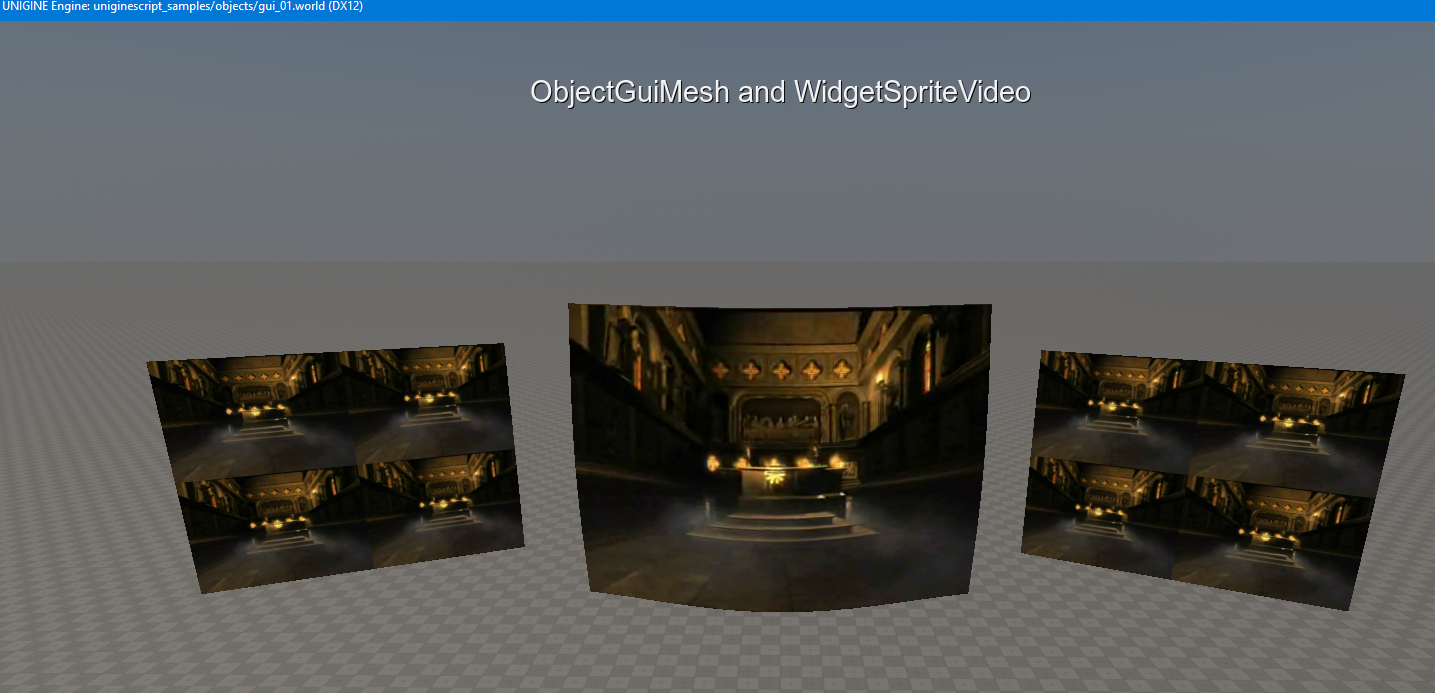

silent Posted December 8, 2025 Posted December 8, 2025 Hi Stephane, Engine currently supports only a single video format - ogv (Theora). You can render video using WidgetSpriteVideo and with a help of ObjectGUIMesh to assign it to any mesh with UV instead of regular albedo texture: There are some samples available as well: SDK Browser -> Samples -> UnigineScript Samples -> Objects -> gui_00 (and gui_01) Thanks! 1 How to submit a good bug report --- FTP server for test scenes and user uploads: ftp://files.unigine.com user: upload password: 6xYkd6vLYWjpW6SN
