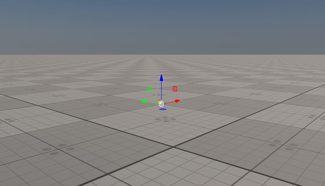

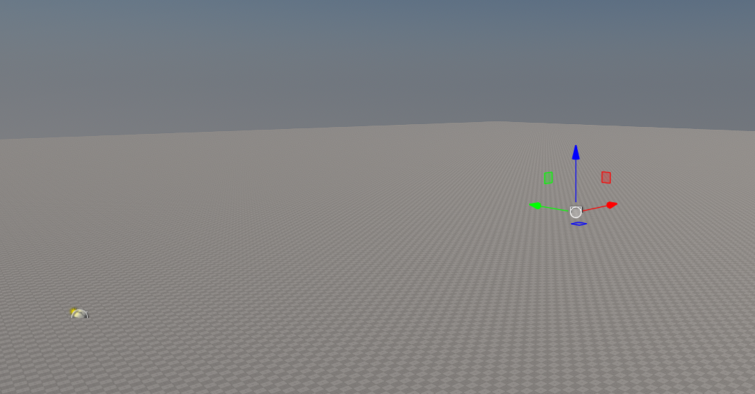

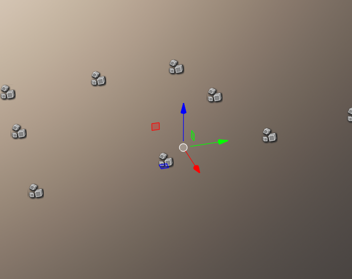

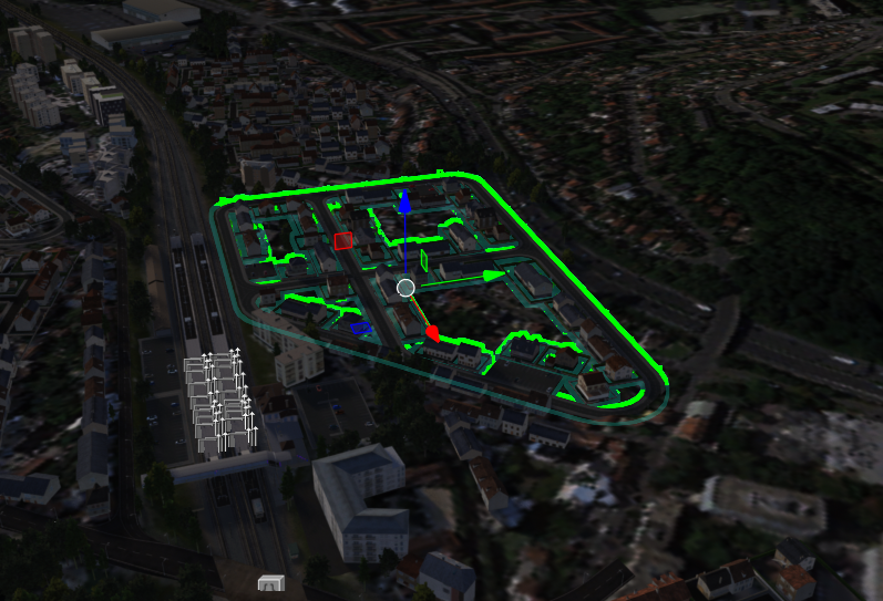

K.Wagrez Posted October 23, 2025 Posted October 23, 2025 Hello everyone, I noticed an annoying bug when working with Unigine 2.19.1 compared to working with 2.18. I have lagre worlds and use a lot the F key to focus on my target. It generally worked pretty well, but in 2.19.1 it focus extremely far from the target, if I don't have a mesh selected. Here is an example. Let's say I selected directly a mesh and I focus on it: So far so good. But what if this mesh has an empty parent (no sibling) with no transformation. Let's select this parent and let's focus again. Woops. I'm too far. Reeaaaally too far, clipping just removed my entire world ! It happens all the time on every non-mesh object, including all the node references and the node dummies parents of meshes ! It worked in 2.18. This is very annoying. Is is some setting that broke during migration ? PS: here is the hierarchy of the node I focused, but since this behavior appears on every node, I don't think it matters.

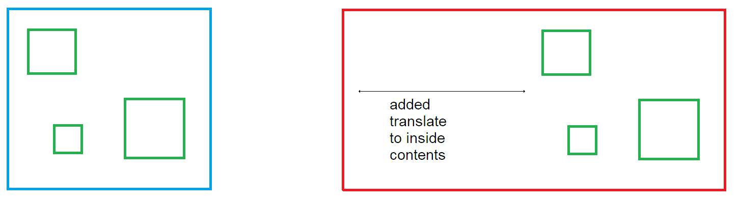

silent Posted October 28, 2025 Posted October 28, 2025 Hi Kevin, We have found something strange related to the NodeReference focus inside Editor. More likely you are facing the same issue in your project, but we could tell more if we would be able to check a small video on how focus works in your case. But this focusing behavior was already there in 2.18.1. To be more specific, if you have meshes inside that extends the bound of the NodeReference - the focus would take in account that extended bound: The content itself remains unchanged; only its coordinates within the NodeReference are adjusted. This is the only scenario we've identified so far that could cause the focus to jump too far from the NodeReference. Please check the exact mesh positions inside the NodeReference, and if they’re placed far from the NodeReference's origin, the resulting bounds can become very large. It's possible this focusing behavior was different in earlier versions (perhaps even before 2.18). We're currently investigating when this behavior first appeared. It's also possible you've encountered a different issue that we haven't been able to reproduce yet. Thanks! How to submit a good bug report --- FTP server for test scenes and user uploads: ftp://files.unigine.com user: upload password: 6xYkd6vLYWjpW6SN
