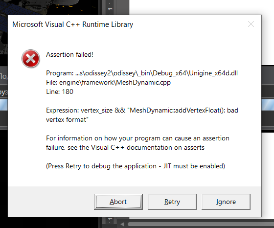

I'm having issues initializing ObjectDynamic with vertices following the code from this topic:
Unigine 2.7.3 x64 Double, C# wrapper
Code:
ObjectDynamic.Attribute[] attributes = new[]
    new ObjectDynamic.Attribute
        offset = 0,
        type = ObjectDynamic.TYPE_FLOAT,
        size = 0
_wireframe = new ObjectDynamic();
_wireframe.setSurfaceMode(ObjectDynamic.MODE_LINES | ObjectDynamic.MODE_POINTS, 0);
_wireframe.setVertexFormat(attributes);
_wireframe.setMaterial("wireframe", 0);
_wireframe.allocateIndices(4);
_wireframe.addSurface("surface_0");
_wireframe.addVertexFloat(0, new[] { -3f, 3, 4f });
_wireframe.addVertexFloat(0, new[] { -1f, 0, -2f });
_wireframe.addVertexFloat(0, new[] { 2f, -4f, 0 });
_wireframe.addVertexFloat(0, new[] { 2.5f, -1, -3f });
_wireframe.addLineStrip(4);
_wireframe.setPosition(new vec3(40, 40, 0));
_wireframe.flushVertex();
Error is caused by the first `.addVertexFloat` call.
