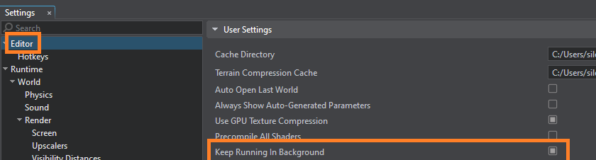

Posted (edited)
Well thanks, that was awfully easy. Can't believe I missed that one
Edit: Well it seems to work sometimes, when part of the editor is still on display, but there are times when it seems to get stuck. For my use, I think it will be enough :)
