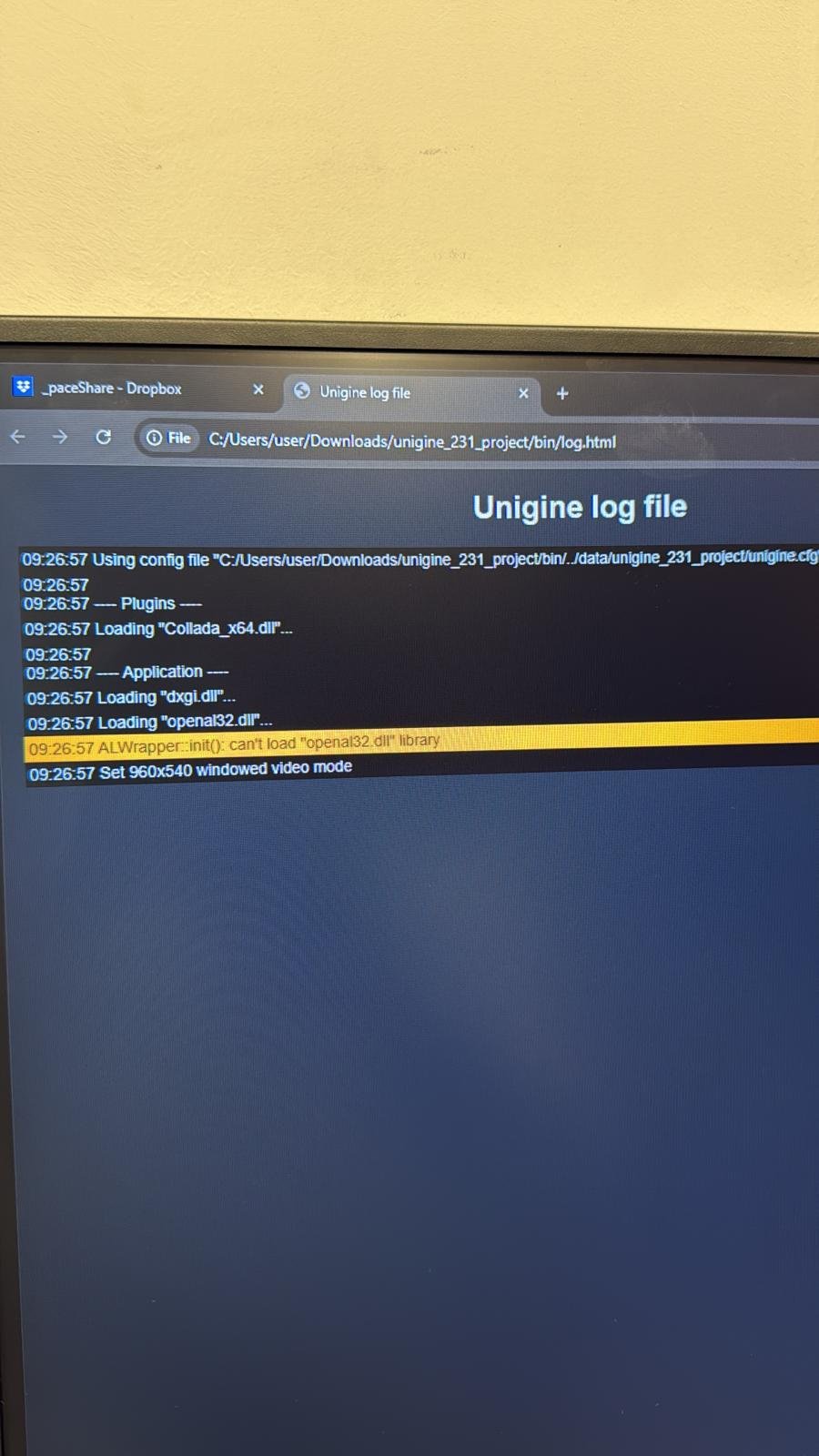

werner.poetzelberger Posted September 26 Posted September 26 Dear Silent, hope you are good! :) We have a kind of similar issue with UNIGINE 2.3.1 with a brand new PC (in NYC, so remote location), where it seems, that the work (software, engine et.al.) behave the same way. It is a different artwork of our, but usese the same Engine version. The first thing is, that at startup, we dont get very far, so debugging is really hard (see attached image). Our man in NYC has done the following: ALL changes with out success starting the work (as well a small emty 2.3.1 testproject) Changed NVIDIA drivers, updated and rolled back to an older version - USING a RTX 5070 Swopped GPU to a 3090 - driver tests as well Updated BIOS Changed OS from Windows 11 to Windows 10 Althoughm we already heard from you, that debugging/solving is not possible any more, wwe are kind of clueless from which part (software or hardware), this issue is derived from. According the PC-report, it is as well using an Intel GPU (onboard) - we suspected the Intel GPU in the other PC we had here in Vienna. Could it be, that somehow UNIGINE tries to start with the integrated GPU? (Is there a way to start it dedicated on a specific GPU?), maybe also diabling in the bios might help? (If possible) Any other hardware components, which could interfere with the start of the Engine..? If you have any hints which can help us investigating further, that might be very helpful. All the Best! Werner

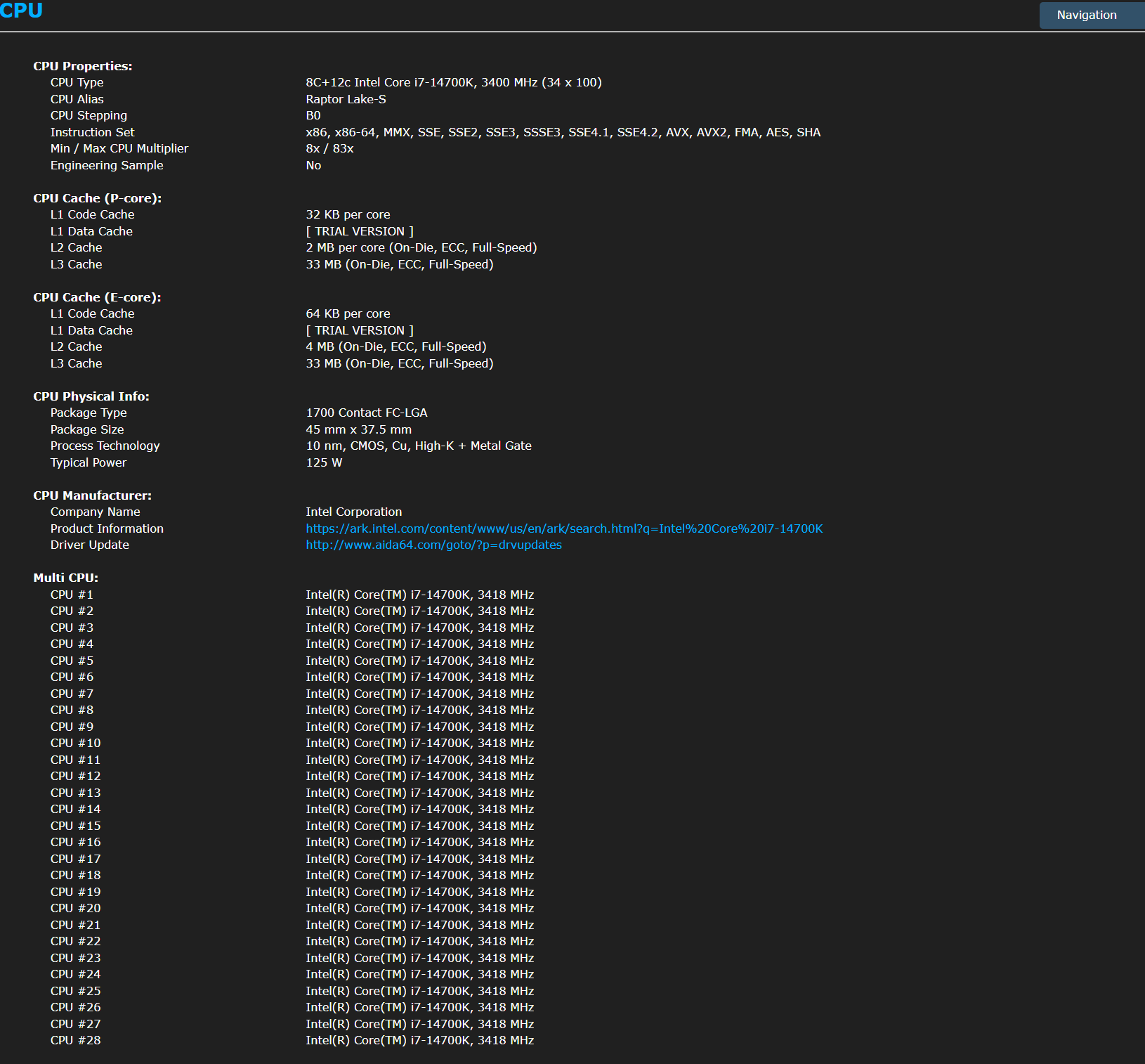

silent Posted September 26 Posted September 26 Hi Werner, The system requirements for version 2.3 are listed in the documentation, and as far as I can tell, there is nothing unusual there: https://developer.unigine.com/en/docs/2.3.1/start/requirements Currently we have 0 ideas why 2.3.1 may not start on regular PC, other than theory that it's somehow trying to use Intel GPU first and fails for some another unknown reason. If you can share dxdiag info from your PC - we can try to find similar PC on our test farm and check the same behavior on our side. Thanks! How to submit a good bug report --- FTP server for test scenes and user uploads: ftp://files.unigine.com user: upload password: 6xYkd6vLYWjpW6SN

silent Posted September 29 Posted September 29 @werner.poetzelberger@helmut.bressler The issue is not related to the GPU, but rather CPU. In 2.3.1 there is a limitation on how many CPU threads can microprofile use (32) and on modern CPUs with 10+ CPU cores it can easily try to allocate more than 32 threads and crash. To avoid this you can start application and limit number of active CPU cores for it. The best would be just to keep 8 (or 4 cores). How to do it you can check in this forum post about CPU Affinity: https://www.eightforums.com/threads/cpu-affinity-shortcut-for-a-program-create-in-windows.40339/ The main limitation is that the affinity mask needs to be adjusted for each specific CPU, especially if you plan to use the application across different hardware setups. However, this process can be easily automated through a simple *.bat launcher that can be included with the application. Hope that helps :) How to submit a good bug report --- FTP server for test scenes and user uploads: ftp://files.unigine.com user: upload password: 6xYkd6vLYWjpW6SN

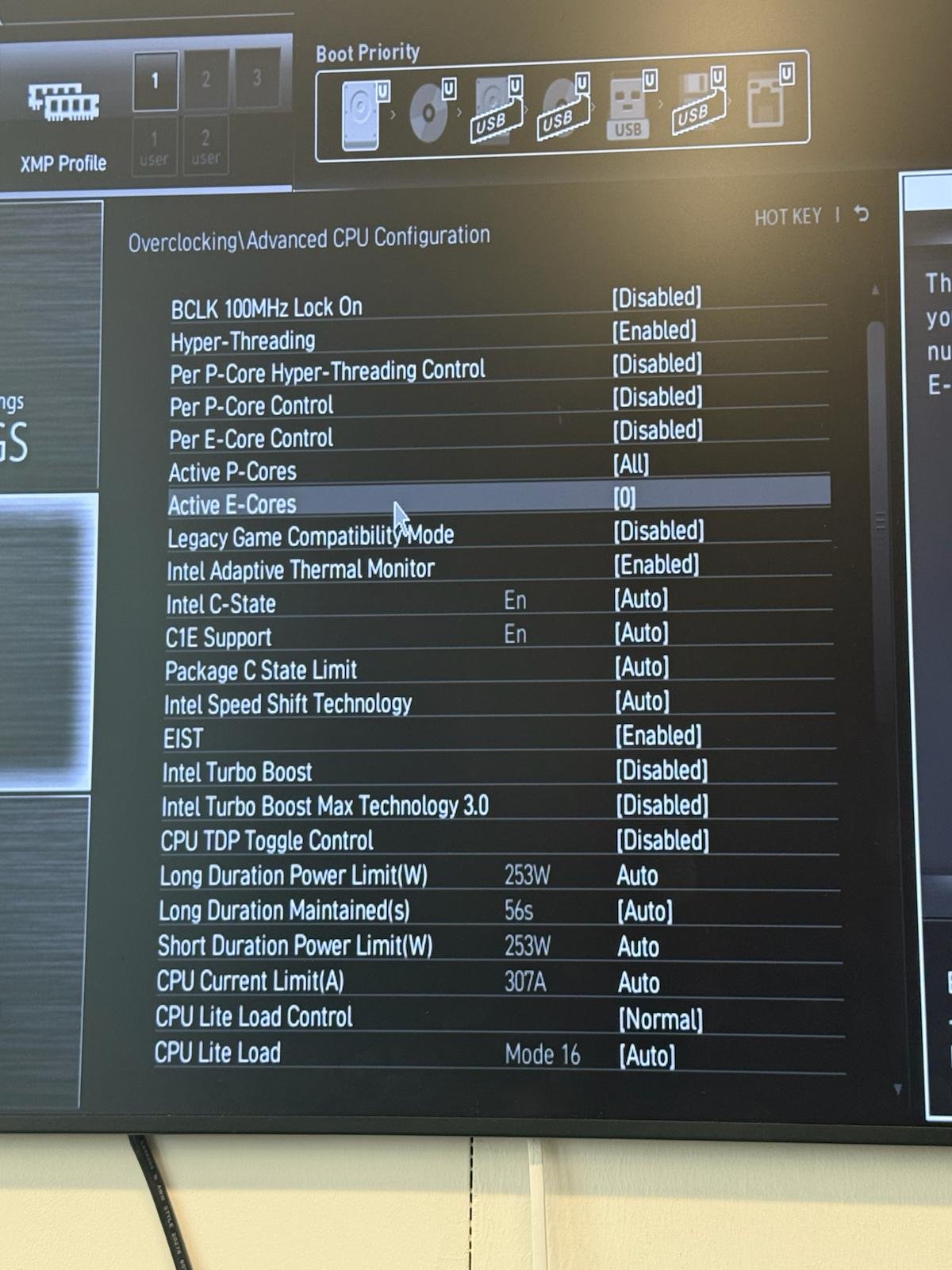

silent Posted September 29 Posted September 29 Yes, number of cores is too big on that one :) This CPU have 8 performance cores and 12 efficiency (8+12 cores / 16+12 threads). You can try to disable all the efficiency cores in UEFI/BIOS and engine should start (in theory). That should give you 8 cores / 16 threads CPU behavior. If engine will not start after e-cores disable you can try to go even further by disabling HyperTreading (not sure if that's even possible in UEFI/BIOS), which effectively will make your CPU 8 cores / 8 threads. How to submit a good bug report --- FTP server for test scenes and user uploads: ftp://files.unigine.com user: upload password: 6xYkd6vLYWjpW6SN
werner.poetzelberger Posted September 29 Posted September 29 GOod News Silent. This seems have fixed the issue! Thank you so much, without your hints we would not be able to do this!! hero!!! All the best! Werner 1
