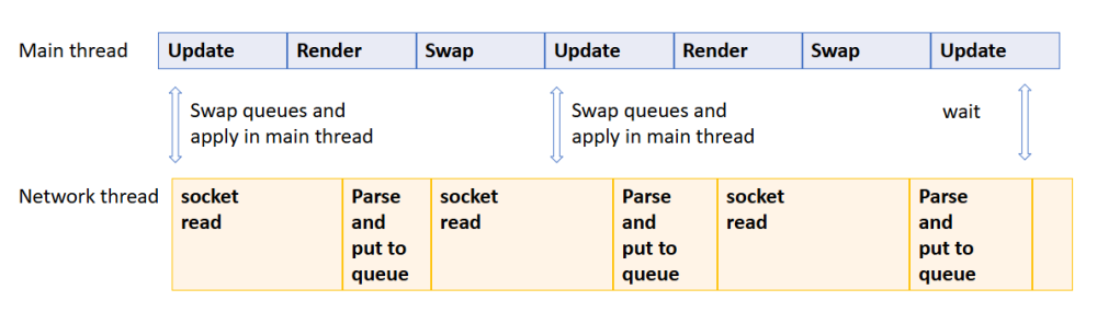

cash-metall Posted December 17, 2024 Posted December 17, 2024 Hello! There are no restrictions on creating threads on the engine side. You can create and use any threads. The main thing you need to remember is that the engine is not thread-safe, so it's better to move nodes or modify any parameters in the update. Here is an article that explains in more detail what can and cannot be done in different threads. https://developer.unigine.com/en/docs/2.19.1/code/fundamentals/thread_safety/?rlang=cpp&autotranslate=en When working with networking, the main pattern is to move the socket read and write logic to another thread, as these operations can be blocking and cause spikes in the frame rate. However, at the beginning of update, we simply retrieve the received and parsed data from the socket thread, applying them in the main thread. In this case, blocking operations involving the queue should be kept as short as possible to avoid blocking the main thread. That is, you should not lock the queue while reading from the socket. You can also check out examples in demos/cpp_component_samples/networking, which include an example of an asynchronous queue for making HTTP requests (image and weather) and http responce (image and camera position).
luoczeng Posted December 17, 2024 Author Posted December 17, 2024 4 hours ago, cash-metall said: Hello! There are no restrictions on creating threads on the engine side. You can create and use any threads. The main thing you need to remember is that the engine is not thread-safe, so it's better to move nodes or modify any parameters in the update. Here is an article that explains in more detail what can and cannot be done in different threads. https://developer.unigine.com/en/docs/2.19.1/code/fundamentals/thread_safety/?rlang=cpp&autotranslate=en When working with networking, the main pattern is to move the socket read and write logic to another thread, as these operations can be blocking and cause spikes in the frame rate. However, at the beginning of update, we simply retrieve the received and parsed data from the socket thread, applying them in the main thread. In this case, blocking operations involving the queue should be kept as short as possible to avoid blocking the main thread. That is, you should not lock the queue while reading from the socket. You can also check out examples in demos/cpp_component_samples/networking, which include an example of an asynchronous queue for making HTTP requests (image and weather) and http responce (image and camera position). Thank you very much! You answered all my major questions. I believe I can work the rest out. Thanks again! You're my hero and saved my day!
