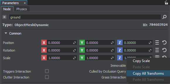

We have planned to solve it on Editor side by adding the ability to copy parameters, as the same way it is done for object transformations here:

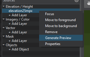

Actually, this is already solved in 2.14, when generation process is started the most recent file will be used from disk, but the problem is still remains with the preview image, it will be shown old result used from cache since we can't track changed files all the time. To update preview image you need to restart Sandworm project or manually click on "generate preview" on file from menu by doing right mouse button click

Hi, ok yes it's a trick I found, just somehow a workaround, not fully reliable, just wanted to share the discover :) Otherwise yes copy/paste parameters was also what I add in mind, but question: Does this works between 2 open editors?

It should work if initially designed right. Perhaps this might be implemented in some other way too, but anyways we will try to add such functionality in some of future versions.
