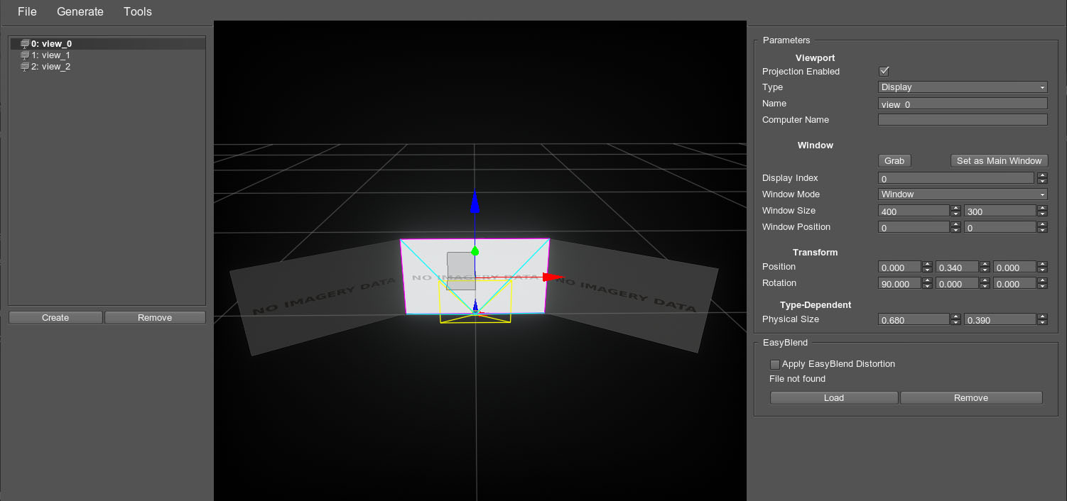

  4. If you previously had a project that used multi-monitor display, i.e. you have a *.cfg file that you want to use, import it (File -> Import). See more details here.
    Otherwise, start creating a new configuration file: add a viewport (click Create on the left panel and select the viewport that has been added to the viewport area) and configure it by setting its type depending on how the image will be rendered — on the display or by a projector. Configure all other settings.

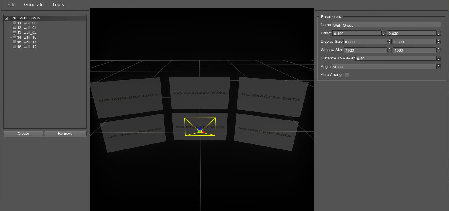

    You can also quickly generate a wall of viewports (Generate -> Wall) and configure the viewport settings for them in a group or individually:
    To initiate rendering of the configured viewports or apply any changes, save and load the configuration file.
