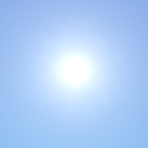

Bloom
Resolution Resolution of the bloom effect:
  • Quarter - quarter resolution.
  • Half - half resolution (by default).
  • Full - full resolution.
Scale Scale of the bloom effect.
Power Power of the bloom effect.
  • At the minimum value of 0.0, the bloom effect is blurred.
  • At the maximum value of 1.0, the bloom effect is more contrast.

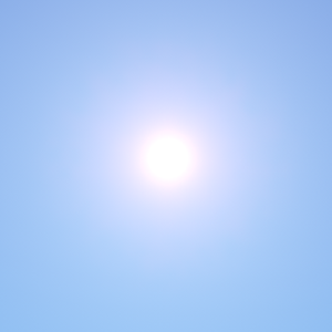

Cross
The parameters described below are available only when cross flares are enabled (Rendering -> Camera Effects -> Cross).
Default cross flares
Color The color of a cross flares.
Scale A multiplier for a color of cross flares.
Scale = 0.4 (by default)
Scale = 0.7
Shafts The number of shafts in a cross flare.
  • The maximum number of shafts is 32 (high number of flares can cause a FPS drop on low-performance hardware).
Shafts = 1 (minimum)
Shafts = 6 (by default)
Shafts = 32 (maximum)

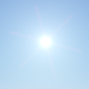

Sun Shafts
The parameters described below are available only when the light shaft effect is enabled (Rendering -> Sun Shafts).
Shaft flare around the sun
Color The color of light shaft.
Scale A multiplier for a color of shaft flares.
Scale = 1 (by default)
Scale = 2
Length Length of light shaft.
Length = 0.8
Length = 0.95

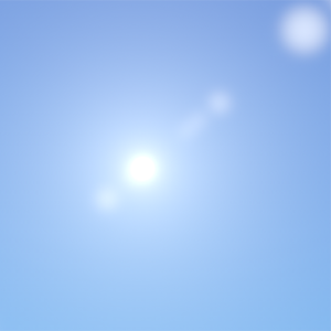

Lens
The parameters described below are available only when lens flares are enabled (Rendering -> Lens).
Lens flares
Color The color of lens flares.
Scale A multiplier for a color of lens flares.
Scale = 0.25
Scale = 0.5
Length Length indicating if the whole radial lens flare is rendered on the screen or only a part of it. This option controls how lens flares pattern is distributed.
Radius A radius of the spherical lens flares on the screen.
Radius = 0.07
Radius = 0.1
Threshold The brightness threshold for areas to produce flare:
  • The higher the threshold value, the brighter the area should be to produce flare.

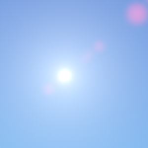

Red Color displacement for the red channel of the lens flares.
Red = 0.9
Red = 1
Red = 1.1
Green Color displacement for the green channel of the lens flares.
Green = 0.9
Green = 1
Green = 1.1
Blue Color displacement for the blue channel of the lens flares.
Blue = 0.9
Blue = 1
Blue = 1.1
