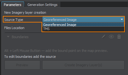

Adding a Data Source#
Sandworm works with both offline and online data sources:
  • Georeferenced Image — for adding offline data stored on the PC
  • TMS — for using online data by adding the link
If you don't want to generate an added source, you can either delete or disable it in the Sources list.

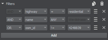

Filtering Vector Data#
Filtering of mask data is described here.
Filters are used to pick specific data from a vector source and create the required types of objects only. By default, no filters are set and all data available in the source are used to generate the specified object.
Currently, only *.shp and *.geojson are supported as assets. Therefore, if you have other types of files, you can try to add them as External Files.
Add a vector source to set filters. As you select an already created object to modify its filters, ensure that you have selected a source in the sources list:
Sources in this list can also be disabled and deleted. If you delete the only source, the object also will be deleted.
The Filter is a set of rules created using the Attributes.
Binary operation
Binary Operators
Binary operators AND and OR that allow combining several filters.
Attribute name Name of the attribute available in the attribute table.
Attribute condition
Attribute Conditions
The available conditions are: =, !=, >, <, ANY. ANY generates all the objects that have any value assigned for the selected Attribute.
When using > and <, make sure that the selected Attribute value type is a number. String comparison may cause issues.
Attribute value Value of the attribute available in the attribute table.
