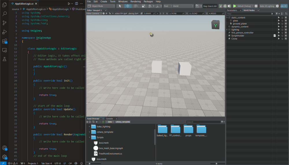

Sevdat Posted July 5, 2024 Posted July 5, 2024 (edited) Good day, The Unigine engine has a minimum windowed scale. I want to have vscode and the engine open at the same time half by half, but can't. Is there a setting which will allow users to decide how much the scale of the engine window will be? This is how it currently looks: Edited July 5, 2024 by Sevdat
bmyagkov Posted July 8, 2024 Posted July 8, 2024 Hello! Unfortunately, adjusting this is not possible at the moment. Truth be told this is the first time such an issue has arisen and we can agree it's annoying :) It seems that the main tab is the root cause not allowing you to reduce its minimal length. However, we will file this on our internal bug tracker and hope it will be addressed in the following release this summer :) Thanks! 1
