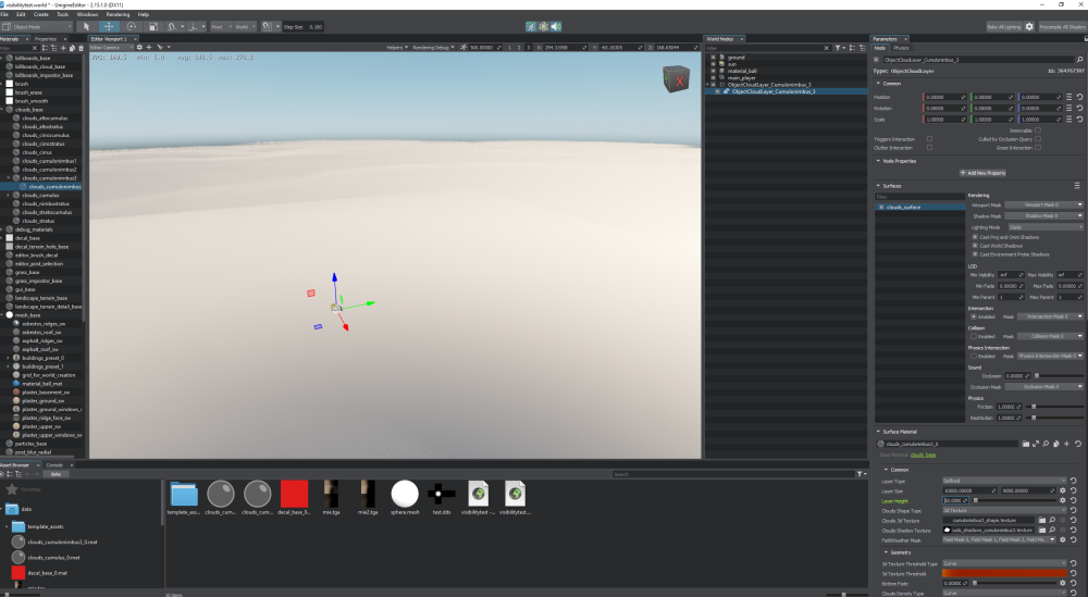

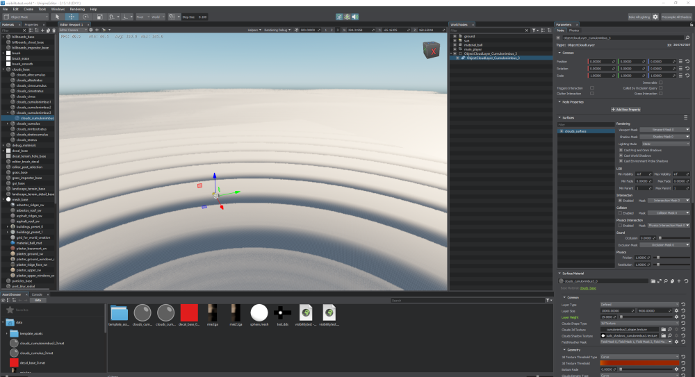

sebastian.vesenmayer Posted December 14, 2023 Posted December 14, 2023 Hello, we try to simulate ground fog with a 3D cumulonimbus cloud. We therefore changed the thickness of the cloud, but when we go below 20 units circles appear in the cloud, which does not look very good. Is there any way to changes this? Layer height of 19: Layer height of 20: Thanks :)
silent Posted December 14, 2023 Posted December 14, 2023 Hi Sebastian, Cumulonimbus clouds are not supposed to be so thin, so I would recommend to try a different preset. And you also can try to move the cloud node below the ground and avoid chaning the cloud layer height. Thanks! 1 How to submit a good bug report --- FTP server for test scenes and user uploads: ftp://files.unigine.com user: upload password: 6xYkd6vLYWjpW6SN
