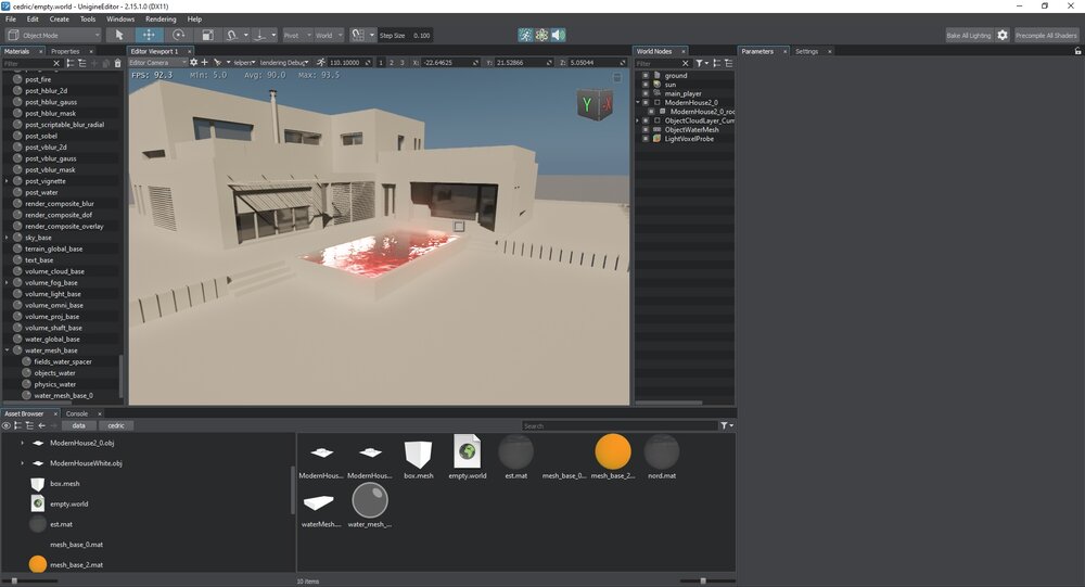

fabre.cedric Posted September 28, 2022 Posted September 28, 2022 Hello, I have a strange bug with the 2.15.1 version and dynamic reflection with material and planar reflection. I have made a small vidéo where you can see the bug with the distance that activate/unactivate the dynamic reflection. My glazing appears with red, somtimes blue or green color and sometimes correctly, this is weird :s. Have you got any idea ? ReflectionBug.mp4

fabre.cedric Posted October 3, 2022 Author Posted October 3, 2022 PackModernHouse.upackage Well I have reproduced this bug on the editor !
fabre.cedric Posted October 3, 2022 Author Posted October 3, 2022 Just for information I can reproduce this bug on two computers. One with a RTX3070 and another with a RTX2080S. Sometimes that work well, somtimes the bug appear, this is really weird. Good luck ! 1
