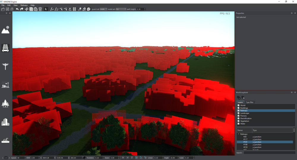

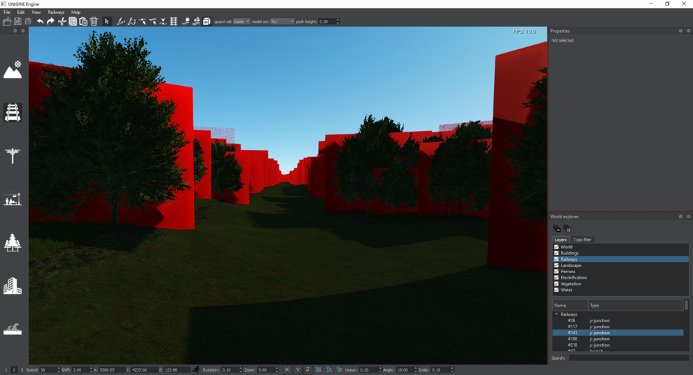

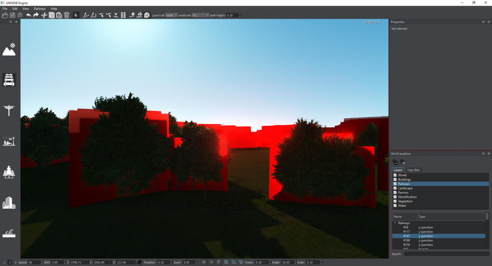

Hello.
I am working in developers team making some sort of train simulator.
I am supposed to test some models, but this weird glitch prevents me from doing my job. None of my timmates have similar issues, so i dont know what is it or how to fix it.
What can you suggest?
My specs:
Unigine 2 Sim 2.13.0.1
Windows 10 Enterprise N 21H1 19043.928 Windows Feature Experience Pack 120.2212.551.0
CPU: Intel(R) Core(TM) i5-2500 CPU @ 3.30GHz   2.70 GHz
RAM: 16.0 GB
GPU: NVIDIA GTX 1060 6 GB
There are screenshots i took moment ago:
image.thumb.png.8100999d117bd6dd3957b73b58fdd837.pngimage.thumb.png.26d54c026934cd82f243fa2f4e9444f8.pngimage.thumb.png.13420c14254eb936d1d2c3548c84ad7e.png

Posted
NicknameLogin
Red textures appears when engine can't load texture that specified in material. You can check engine log file and probably will see some red errors that would indicate that files were not able to load.
Why they can't load - it's hard to tell. Make sure that you have correct permissions set to the data/.runtimes directory and you are not running out of space on that drive where project is located.
We are not familiar with this software and it's hard to tell how it starts and prepare materials, maybe there is a bug inside that only affects your PC. The best option would be to contact devs of this editor and supply them all the log files and screenshots so they can dig further and get a better picture.

Thanks for the quick reply, i will check that log file.
Posted
Issue has been resolved by total shader recompilation. Thanks for help.
