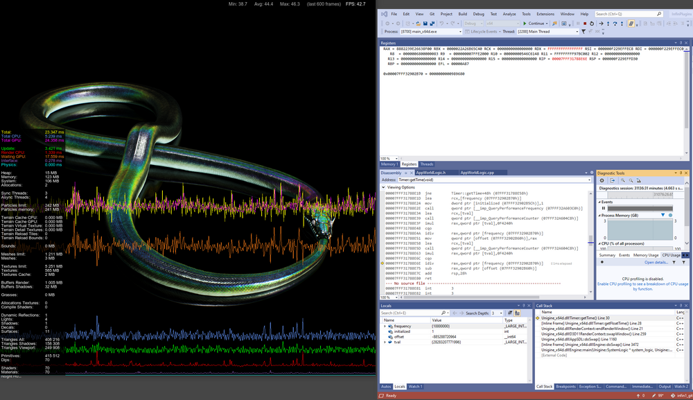

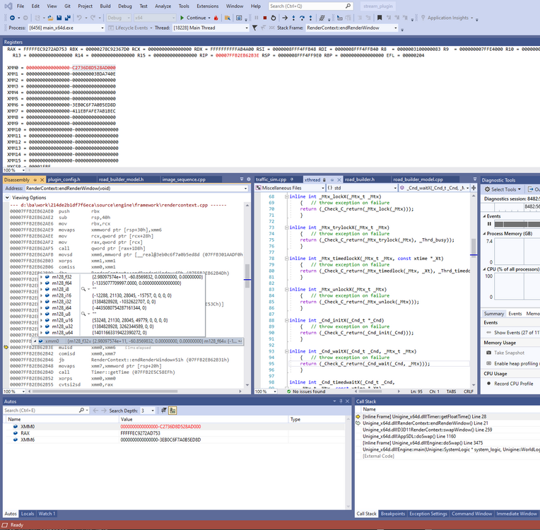

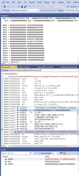

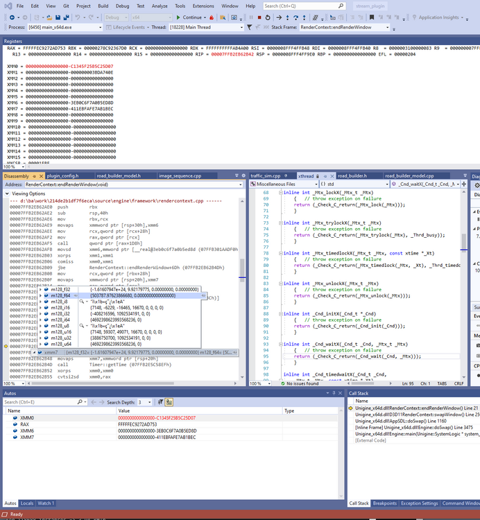

helmut.bressler Posted April 4, 2022 Posted April 4, 2022 Dear Unigine Team, Two of out 2.14.1 based projects are "freezing" after a random amount of time. For one of them I was able to catch the issue in the debugger. It seems that Timer::getTime() returns a negativ value, which causes an infinite loop in RenderContext::endRenderWindow(). Please see the attached small video. When digging out my little bit of assembly knowledge, the following seems to happen: Timer::getTime() writes an 64 bit integer timer value into RAX register the cvtsi2sd converts the signed integer into a double value which is written into xmm0: After that it is multiplied with a positive value stored in xmm6: And finally it is compared with another positive value in xmm7: if the xmm6*xmm0 is less than xmm7 it jumps back to Timer::getTime() which again returns a negative value Of course, I cannot be 100 perecent sure that Timer::getTime() is not delivering some positive value after a certain amount of time (therefore the ? in the title) - but intuitively it seems to be quite strange that a timer returns a negativ value. Could the issue be releated to the render_max_fps setting? It is 150 in the world file, which is never reached. In this particular case the software has been running for 4 days at around 30 fps on Windows 10. I should also mention that we need to fix that quite urgently, because we have to ship the software soon. Many thanks Helmut 2022-04-04 10-36-17.mkv

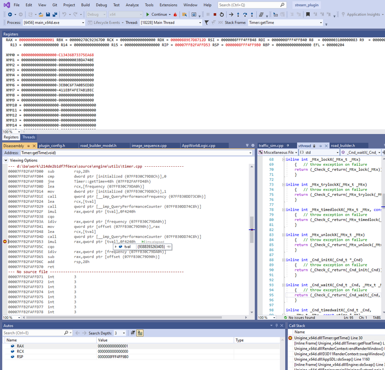

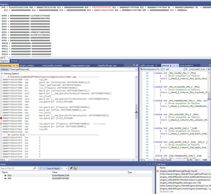

helmut.bressler Posted April 4, 2022 Author Posted April 4, 2022 Little update: I think it is an overflow in Timer::getTime(), which is happening because the value returned by QueryPerformanceCounter() is multiplied with 100000. I think the following is happening: Queryperformance counter just finished its execution, the result is in [tval]. It returned TRUE in the RAX register which is just 1 For some normalisation reasons the result is multplied with 100000 immediately afterwards, this is the place where the overflow happens. The cqo (https://www.felixcloutier.com/x86/cwd:cdq:cqo) instruction following the imul instruction sign-extends the 64 bit value into a 128 bit value located in the RDX:RAX register which is negativ (needed for the following idiv (https://www.felixcloutier.com/x86/idiv) instruction which operates on a 128 bit integer). The idiv instruction uses a negativ number as input (it always uses the pair of RDX:RAX as input). Please observe that RAX starts with 8 in hex, which indicates that RAX was already negativ before the execution of cqo. Also RDX is 0xFFFFFFFFFFFFFFFFFFF which is the negativ sign extension of RAX All the best Helmut

helmut.bressler Posted April 4, 2022 Author Posted April 4, 2022 We will try that, but it will take some time to find out, I should mention that all other places where Timer::getTime() is called (and all other instances, in case it is not static) are affected as well, irrespective of the offset value. And i have seen that it is at least invoked by numerous worker threads - all of them will read negative values. So I think it is something which should be fixed ;-) Thanks Helmut

helmut.bressler Posted April 5, 2022 Author Posted April 5, 2022 @silent Thank you very much for the suggested work around, I think that should be easy to implement. Yeah it is, it is even more mysterious on the second machine. It got stuck in a loop after approximately 3 weeks (but the machine is switched on for much longer). On this machine the Debugger spills out the local variable of the timer variable. If the debugger is correct, the frequency is here only 1000000. It is an old Core I5 4000something CPU (The other one was a quite new 11600k). The strange thing here is that the offset is negativ (I don't know when the offset value is sampled). Maybe this is because the machine has been running for so long already. Anyways the issue is the same. The value returned by QueryPerformanceCounter() multiplied with 1000000 exceeds the range of a signed 64-bit integer and leads to an overflow into minus. And it is actually quite easy to see that the code is problematic. Take for example an imaginary CPU which has a clock frequency of 4.2 GHz (or 2^32 for the sake of simplicity) and QueryPerformanceCounter() uses the RDTSC instruction which simply returns the value of a clock counter. In other words, the counter gets increased by 2^32 per second. The timer implementation multiplies that value with 1000000 (I suppose in order to translate it into microseconds) BEFORE it divides it by the frequency. For our hypothetical CPU that would mean that the overflow happens in the best case after around 2.1 million seconds, which is something between 3 to 4 weeks. (The best case is when the timer is zero when the application starts). Cheers Helmut 1
rohit.gonsalves Posted April 5, 2022 Posted April 5, 2022 Dear Helmut, GetTickCount() will run continuously for 49.7 days. As 2^32 - 1 will cause overflow around zero for storing milliseconds. But QueryPerformanceCounter() returning LONGLONG can save 9,223,372,036,854,775,807 on positive side before turning to negative numbers with an overflow. For your hypothetical CPU of 4.2 GHz, there will be 2^32 - 1 ticks for a second. Then probable seconds stored are 9,223,372,036,854,775,807 / 4,29,49,67,295 ~ much much more than 3-4 weeks. If you replace the code with spin loops for timing and even used GetTickCount64(). I suppose there should not be this small limitation of 3-4 weeks. Even with GetTickCount() with milliseconds precision, the program should run till 7 weeks at-least. Did I miss anything or misunderstood the calculations? Rohit
helmut.bressler Posted April 6, 2022 Author Posted April 6, 2022 Hello Rohit, you are right, both GetTickCount() and QueryPerformanceCounter() are running for a very long time (I think QueryPerformanceCounter() is specified to work for at least 100 years - which actually make my imaginary cpu incorrect (only by a factor of 2 or something)). I think for clarifying whats happening inside Timer::getTime() I'm trying to translate it into C code (Its easier for me to explain things in code, I'm not a text writer :-) static LARGE_INTEGER frequency; static long long offset; ///< in microseconds static int initialized = 0; static UNIGINE_API long long Timer::getTime() { if(!initialized) { // initialise frequency and offset here return 0; } else { LARGE_INTEGER tval; LARGE_INTEGER elapsed; QueryPerformanceCounter(&tval); elapsed.QuadPart = tval.QuadPart; elapsed.QuadPart *= 1000000; elapsed.QuadPart /= frequency.QuadPart; return (long long)elapsed.QuadPart - offset; } } As you can see the elapsed time is multiplied with 1 Million (in order to translate the result into microseconds) before it is divided by the frequency. This is done before the division because the division is an integer division and the frequency is in hertz, but we need microseconds precision. This is problematic because a high frequency can easily eat up all the range benefits from using 64-bit integers. Instead I believe something like the following could be done: static LARGE_INTEGER frequency; static long long offset; ///< in microseconds static int initialized = 0; static UNIGINE_API long long Timer::getTime() { if(!initialized) { // initialise frequency and offset here } else { LARGE_INTEGER tval; LARGE_INTEGER elapsed; QueryPerformanceCounter(&tval); elapsed.QuadPart = tval.QuadPart; if(frequency.QuadPart > THRESHOLD) { elapsed.QuadPart *= 1000; elapsed.QuadPart /= (frequency.QuadPart / 1000); } else { elapsed.QuadPart *= 1000000; elapsed.QuadPart /= frequency.QuadPart; } return (long long)elapsed.QuadPart - offset; } } or something similar - but this sacrifieses some precision. I think the problem is not so trivial to solve with 64 bits - the windows performance counter API allows either to measure the time very precisely but only for a short time span or for a longer timespan but less precisely. A solution could be maybe to use 128 bit integers instead? Another possibilty would be to implement render_max_fps as @silent proposed - subtracting the timestamp from the previous frame makes the elapsed value in the code I posted always small - but this wouldn't solve the issue for Timer::getTime() in general. Cheers Helmut 1
