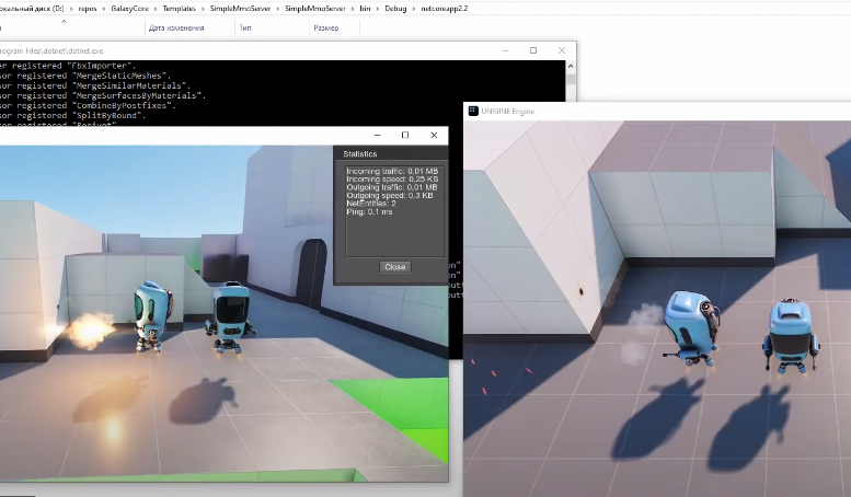

denis.totmin Posted July 30, 2020 Author Posted July 30, 2020 Connecting the Galaxy network to the “Third Party Platform” example. It took 15 minutes to get the result and two small components (network initiator and NetPlayer) 6

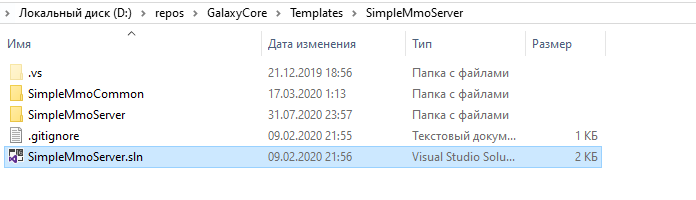

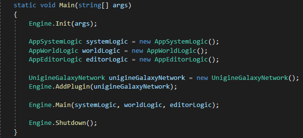

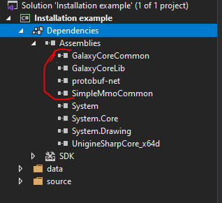

denis.totmin Posted August 1, 2020 Author Posted August 1, 2020 And here is a small instruction for installing galaxy network. You can start testing. The core of the network solution has already passed numerous tests, including in commercial projects, but we are the first in Unigine, and therefore our path in this game engine is just beginning. 1) Download the repository. https://github.com/defraswiew/GalaxyCore 2) Open the server project from the Templates / SimpleMmoServer directory. By default the server uses net. Core 2.2, you can change the version to any version 2.0 and higher 3) Create a new project unigine version 2.11 or use an existing one. 4) We open the project in the IDE. Add all libraries from Templates / Unigine / Libs directory to Assemblies. 5) Drag the contents of Templates \ Unigine \ ToProject \ ToSource to the project source 6) Add the following code to mainUnigineGalaxyNetwork unigineGalaxyNetwork = new UnigineGalaxyNetwork (); Engine.AddPlugin (unigineGalaxyNetwork); 7) Add content emplates \ Unigine \ ToProject \ data to the data folder inside your project. This completes the installation. To make a node networked, you need to add the UnigineNetEntity component to it. In order to automatically create foreign objects, you need to add an empty node with the GalaxyNetworkInstantiator component to the scene Note. This component searches for a node by name. This was a quick guide to installing the galaxy network. Soon I will post an example project and several video instructions on working with the plugin. If you have any questions you can ask me on Discord. https://discord.gg/mHQHyae 2
