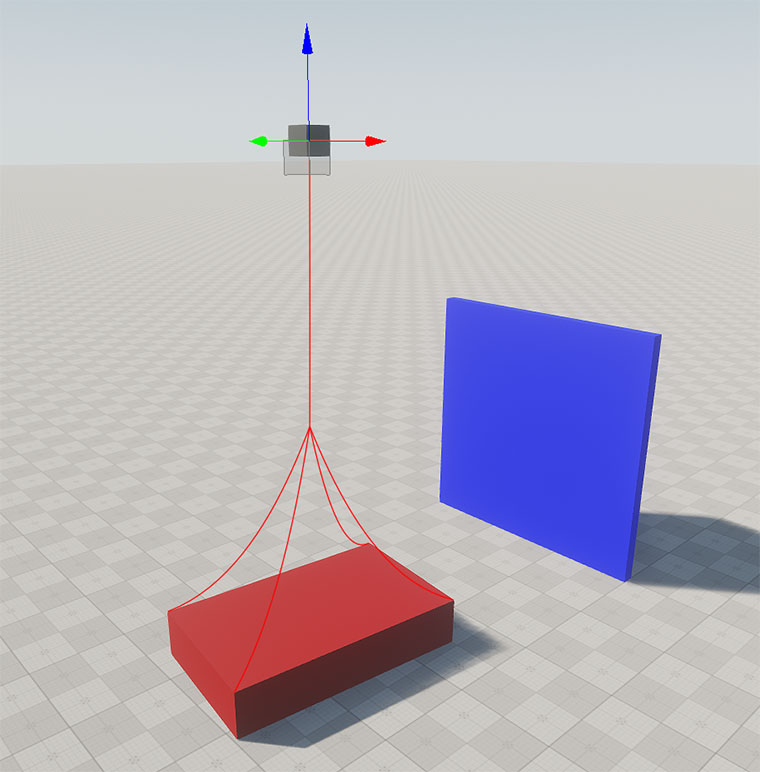

Crane#
The Crane sample demonstrates how to imitate a crane with sling ropes transferring an object. The scene contains the manipulator with the ropes connected to it. Ropes are also connected to the load, which has BodyRigid assigned. The connection points are set via AttachPoint.
You can move the load around the scene by dragging the manipulator with the mouse, and make it interact with the wall also available in the scene.
Physics is simulated at 120 fps with 10 iterations to adjust the distance between points.
The physics update for the load is adjusted by impulses to ensure proper interaction with the environment.
SDK Path: <SDK_INSTALLATION>demos\cpp_sim_samples_demo_2.19.1\source\rope_sample

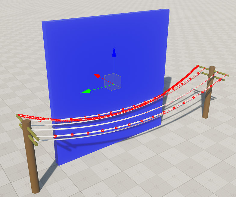

Wires#
The Wires sample illustrates how to create wires using the RopeSystem component. You can change the wire diameter value and generate a wire mesh based on a new value. The plane available in the scene can be moved to make the wires swing.
Simulating wires doesn't require a big number of physics iterations and fps, as they don't move across the scene, only swing. However, if wires in your scene are used mostly for decorative reasons and do not require any physical response, consider using a static mesh to save performance.

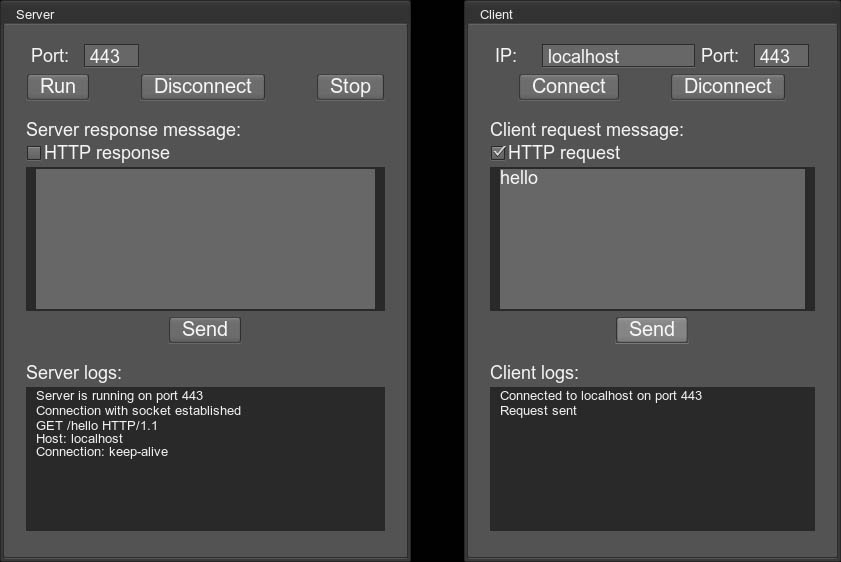

SSL Socket#
SSL Socket sample illustrates the implementation of message exchange with a server through an SSL connection.
It contains two windows: one representing the server, and the other one — the client.
To exchange messages, you need to run the server first (click the Run button in the Server window), then connect the client (use the Connect button in the Client window). Then you can type messages in the message areas and click Send.
SDK Path: <SDK_INSTALLATION>demos\cpp_sim_samples_demo_2.19.1\source\ssl_socket_sample
